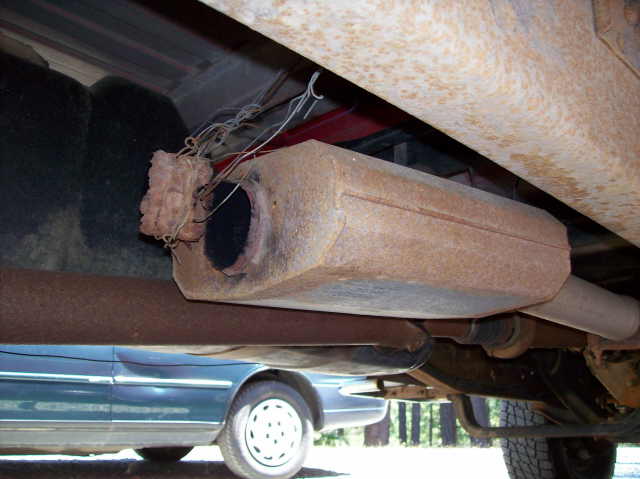

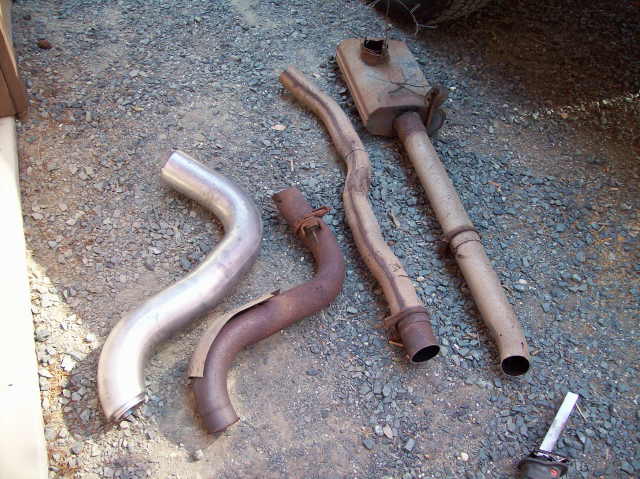

With all the talk about the Diamond Eye kit for $275 I went for it. My old exhaust was getting down right dangerous - to anyone following me! the second picture shows the new downpipe with the old.
Attached Thumbnails 4" Exhaust Install-4-exhaust-004.jpg-just-hangin.jpg   4" Exhaust Install-4-exhaust-010.jpg-old-exhaust.jpg

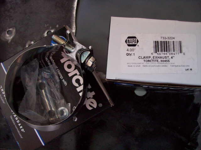

Here's some more pictures. The big box, the Anaconda and the clamp I used. I got the clamps from NAPA for 13.75/ea.

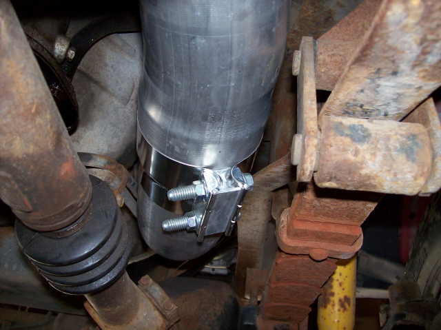

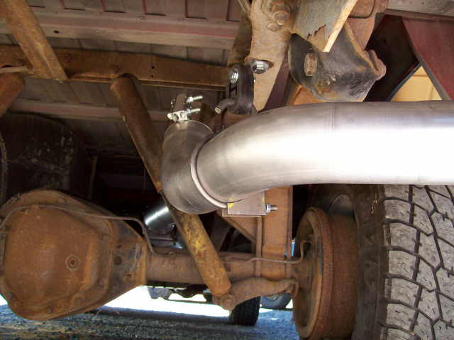

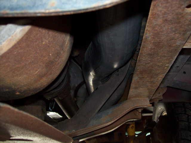

Some installed pictures. It's a tight fit for the down pipe. I took a mini-grinder to the heat exchange tank bracket and made a clearance notch. I also bent the the trans fluid lines going to that tank so the d-pipe didn't rub them. It's also real tight at the x-member bracket. I clearanced the pipe with a single jack beating on it supported by a plastic trash can so the other side of the pipe didn't get dented. It all fits, just real tight! When it gets swapped to the crew, the tailpipe is going to need a major remodel to clear the Ramcharger fuel tank and skid plate.
