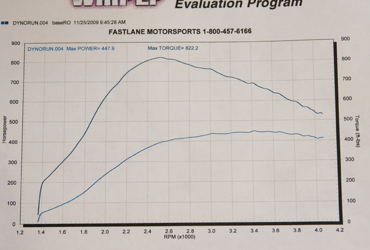

I remember David's (BC847) made peak hp I think around 3600rpm based on a dyno sheet he posted I think over on CF a little while back. I can't remember. I was shocked in any case.
Typically our trucks don't make a lot of power north of about 2800rpm though.
My fueling consists of a Walbro electric lift-pump pushing through a bypass type regulator via 3/8th" lines, which feeds a stock/OEM 12mm VE injection pump (with a modified 3200 spring). From there, the fuel goes to some Scheid 6x.016" EDM injectors. That and a LOT of IP timing advance. The balance of my bombs deal with airflow through the engine.
-> My 3200 rpm spring has two loops cut from it and is stretched to fit in the IP like it ought to (too impatient to find/order a 3800 spring). I'm pleased that the HP curve is fairly flat above 2600rpm. I guess you could say it peaks around 3400 ~3600rpm.

Wow, thats alot of rpm out of a 3200 spring. I no longer have any sort of high idle stop, it just rotates till it hits the pump. So I wonder just what rpm mine will defuel now. Probibly not till long after it throws a rod thru the block.
