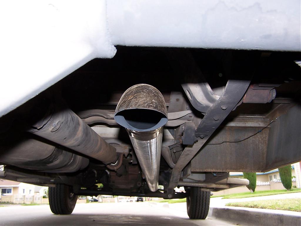

i sure have! i have it dumped just in front of the rear end.
