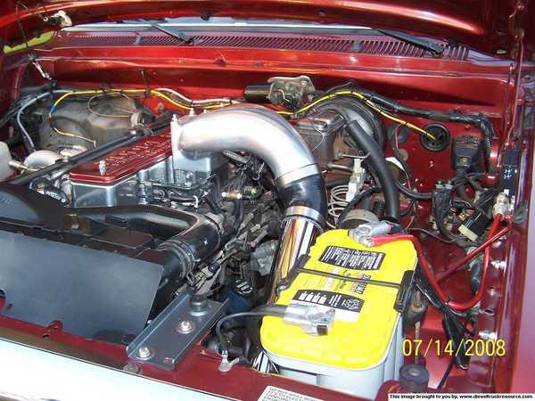

Attached Thumbnails 24v intake horn-100_0967_50%25.jpg   24v intake horn-100_0973_50%25.jpg

oooooooooo shiney me like shiney. haha

Is that a banks intake manifold? If it is I didn't know that it would fit. Looks sweet!
