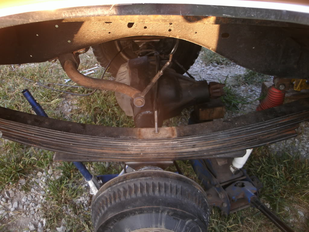

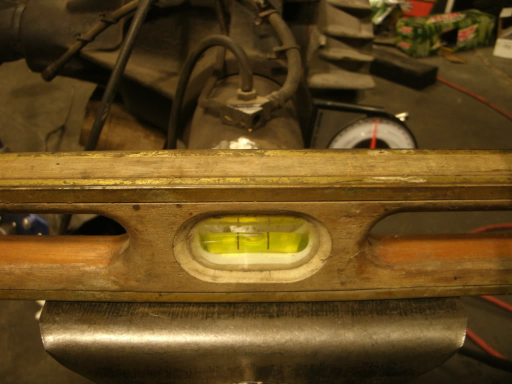

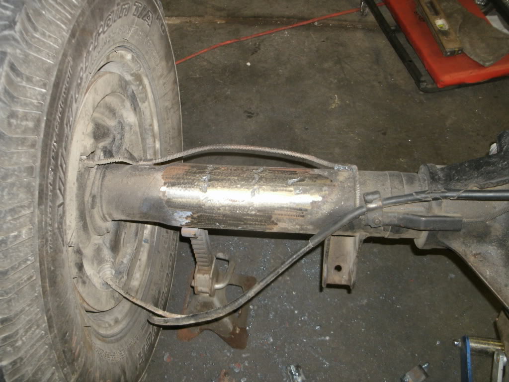

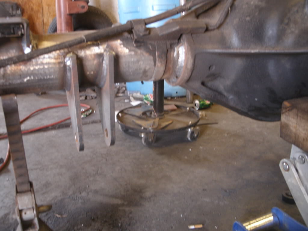

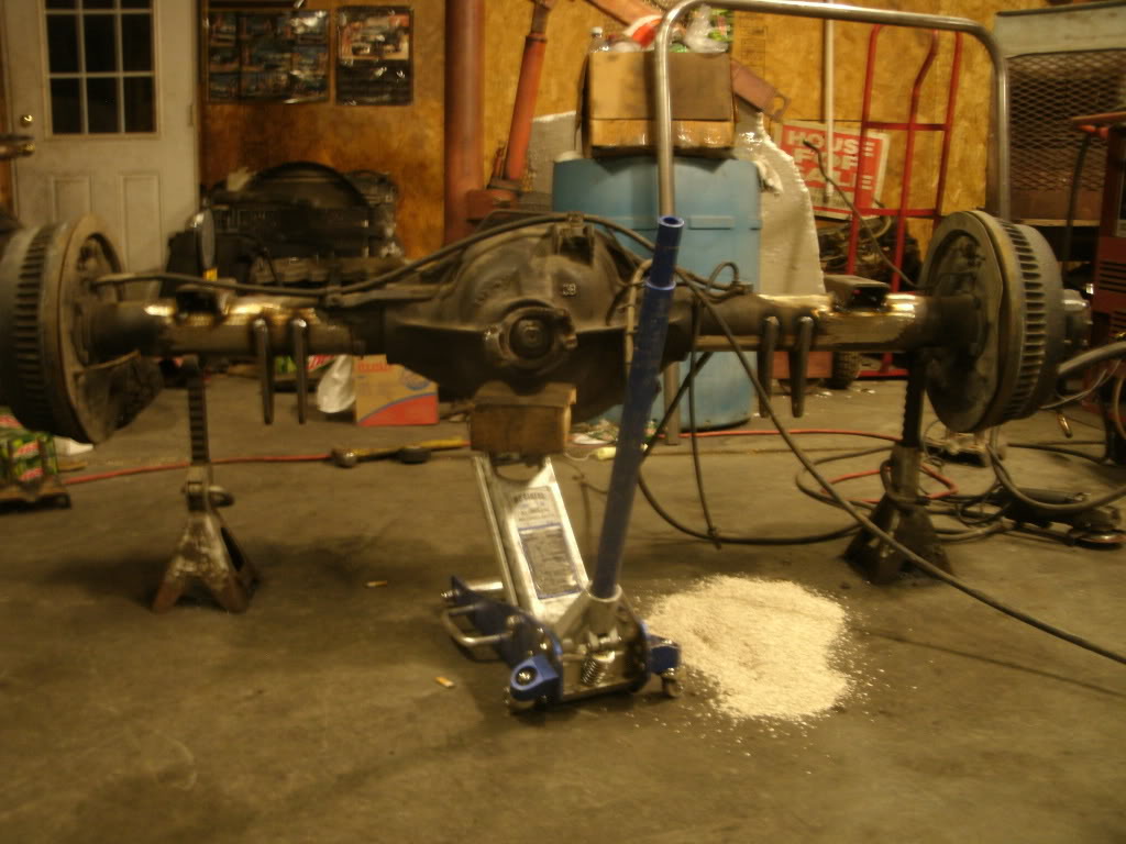

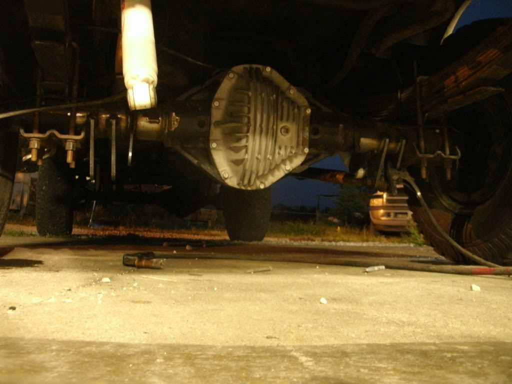

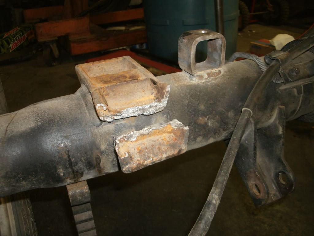

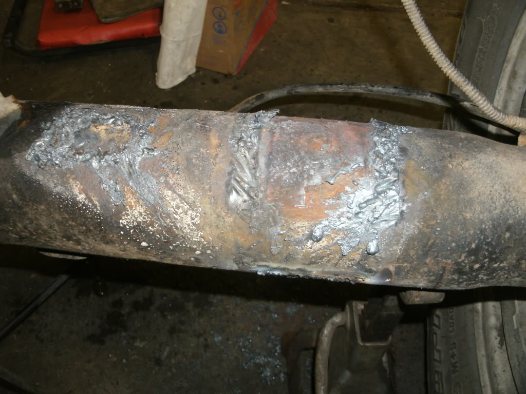

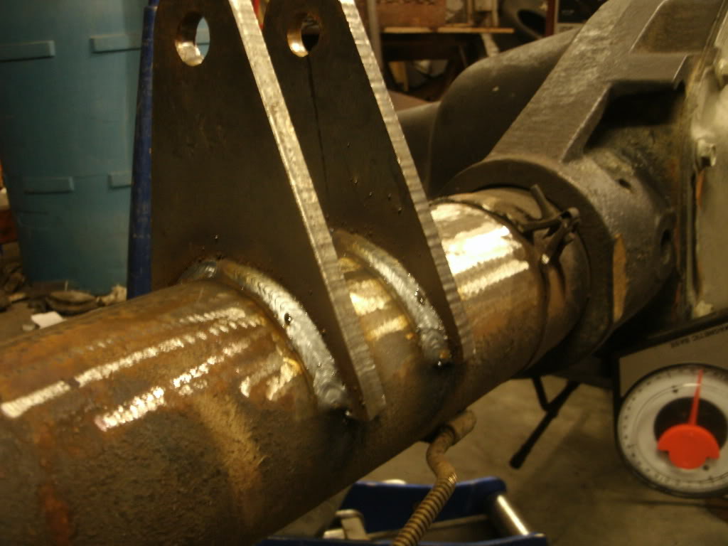

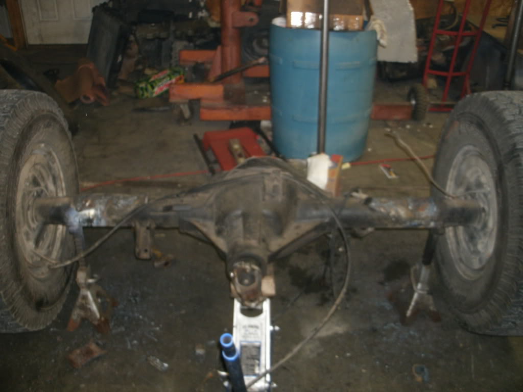

Well its back together now. And I did weld the tubes to the pig.
When I ordered the perches I had em blow some extra spring pin holes so I could offset the axle back and gain an inch of wheelbase

Why didn't you add a bracket to the top to build a set of ladder bars?

Jon, because a ladder style creates forces I don't want, You will never see a ladder style bar on any truck I own that I pull with.
Got some research to do then.

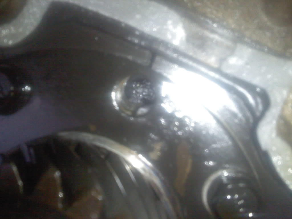

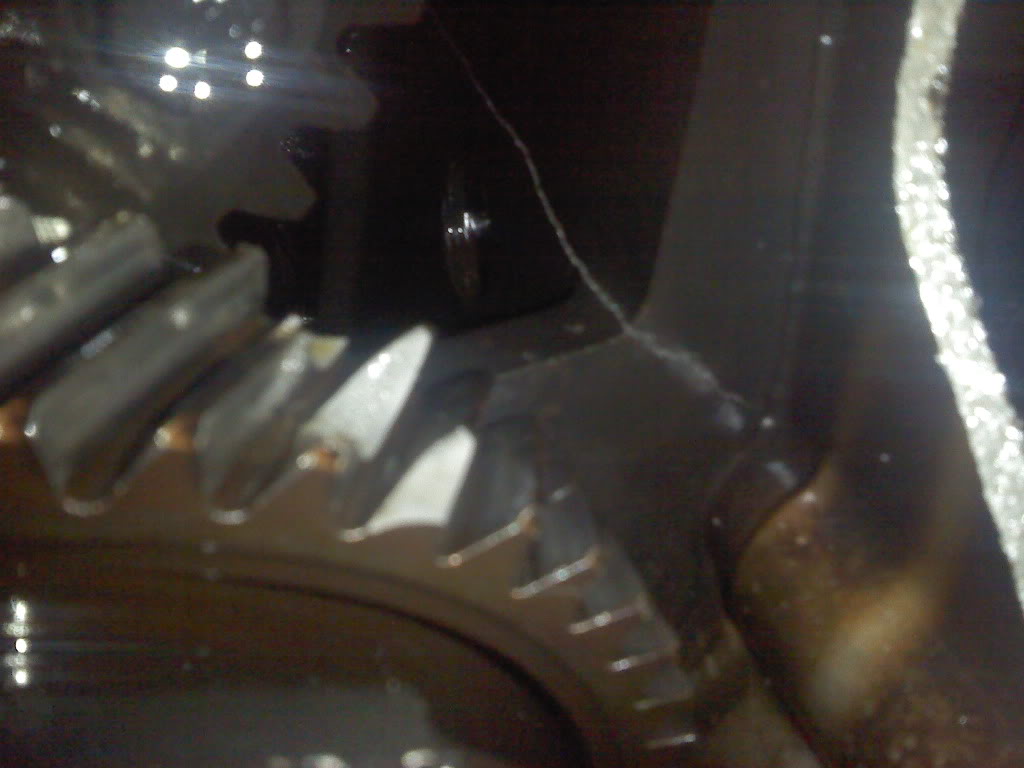

So my season is finaly done thank GOD.

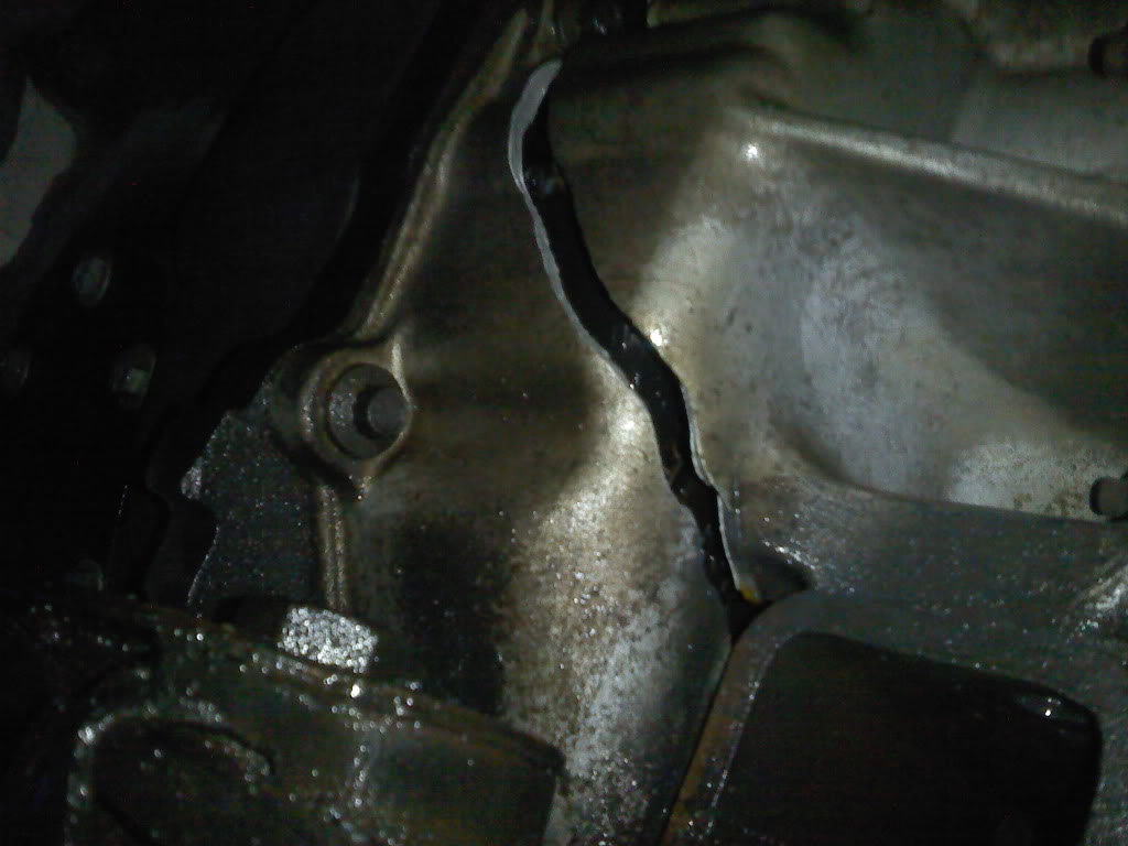

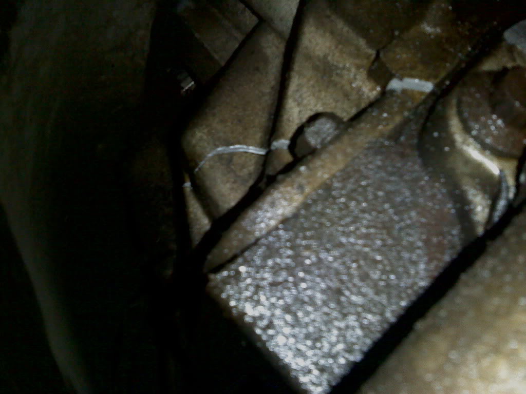

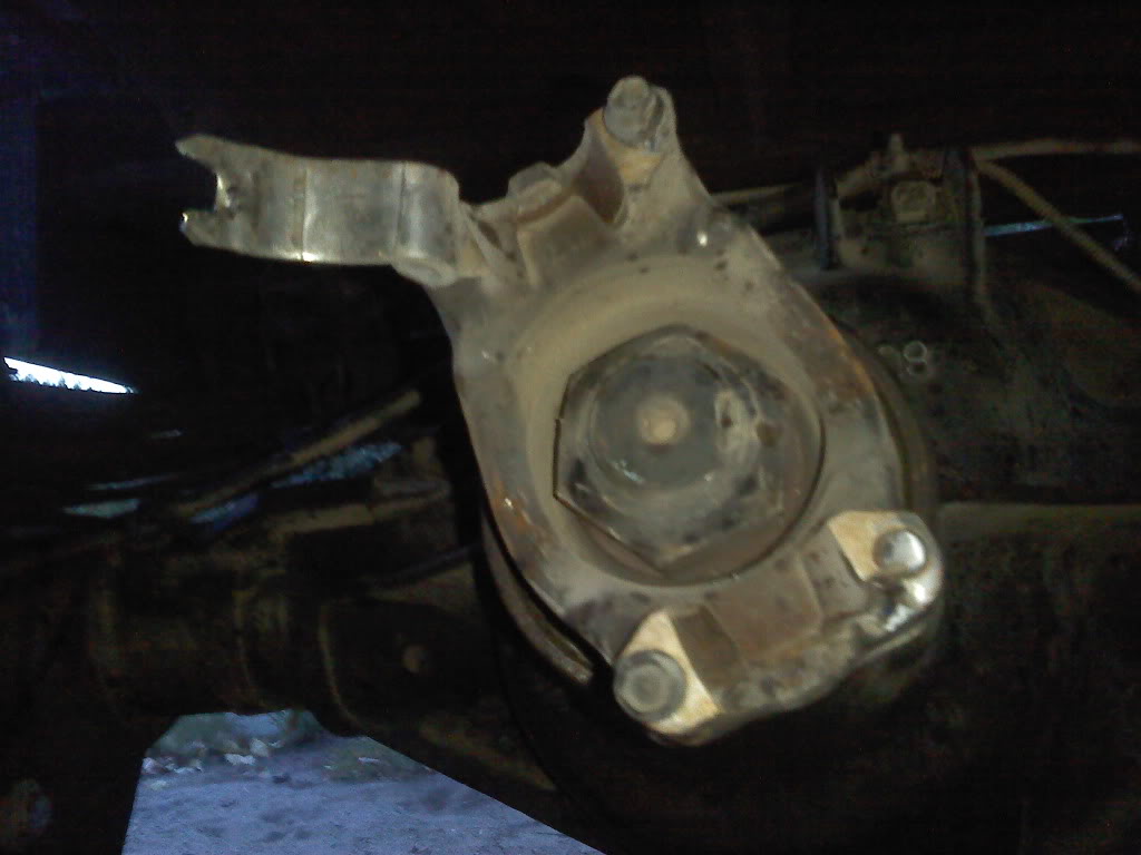

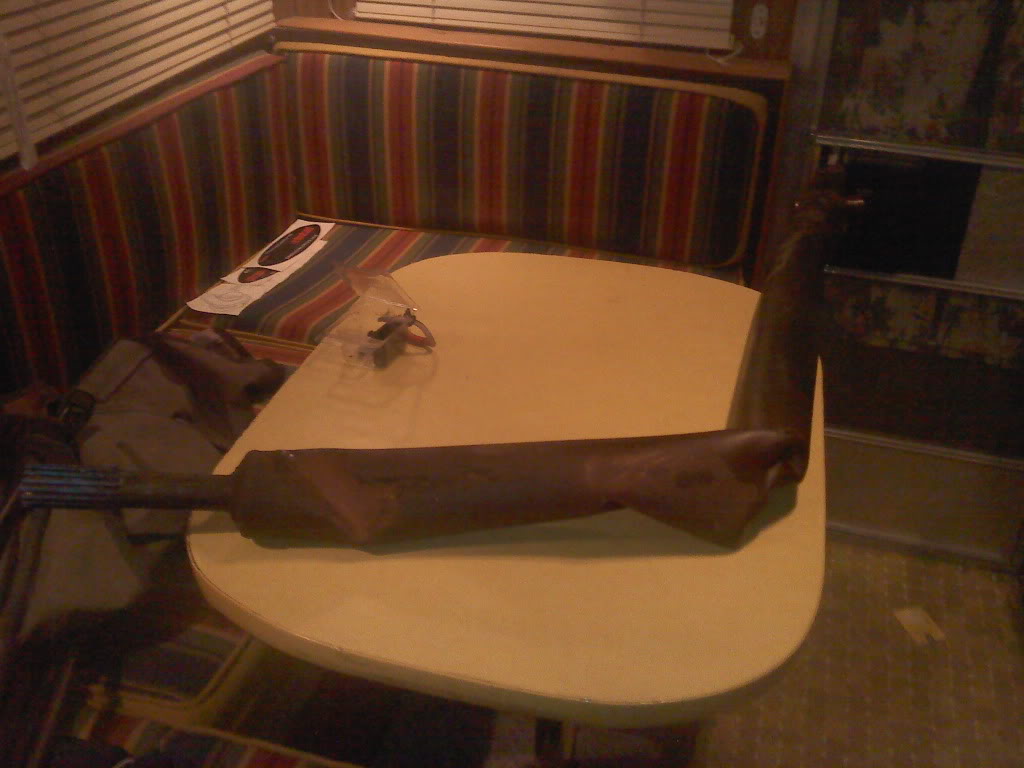

Heres a little summary of where i placed and what I tore up. THis has been the worst year for carnage I've ever had. This last weekend I had some very extreme carnage on the dyno. I kicked the rear shaft on a 5th gear pull with 110mph wheel speed, I wasn't impressed with the numbers but the curve is beautiful. When the shaft decided to leave it whipped bad and broke the rear extension housing on the 4500 then a piece went through the 5th gears and exploded the case and top cover on the 4500.
So heres how the year went.
1- 1st place
2- 2nd place (technicly 1 was a dq)
2- 3rds
2- 4ths
And some mid pack finishes
Crap I tore up including my dyno carnage.
Spring perches 2 times
spring center pins
traction bar axle mount
traction bar frame mount
1 set of traction bars
3 driveshafts
1 u joint
3 sets of straps
2 d80 yokes
1 rear extension housing
1 nv4500 case
1 nv4500 top cover
5th on the main and countershafts.

I see the drive shaft is layin on a camper table....your not reduced to living in a camper down by the river just so you can afford your pulling addiction are you ? ?
Darwin
