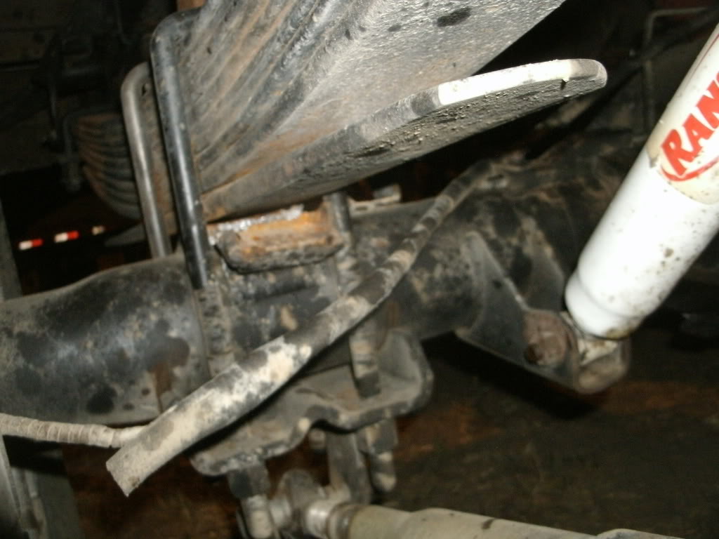

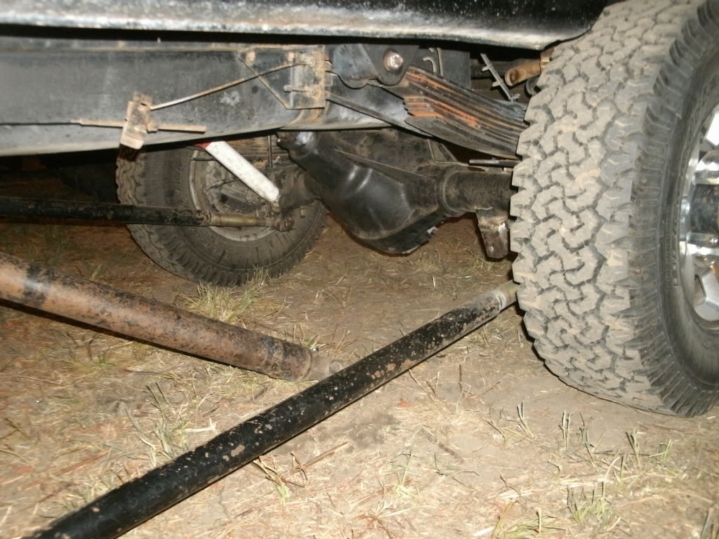

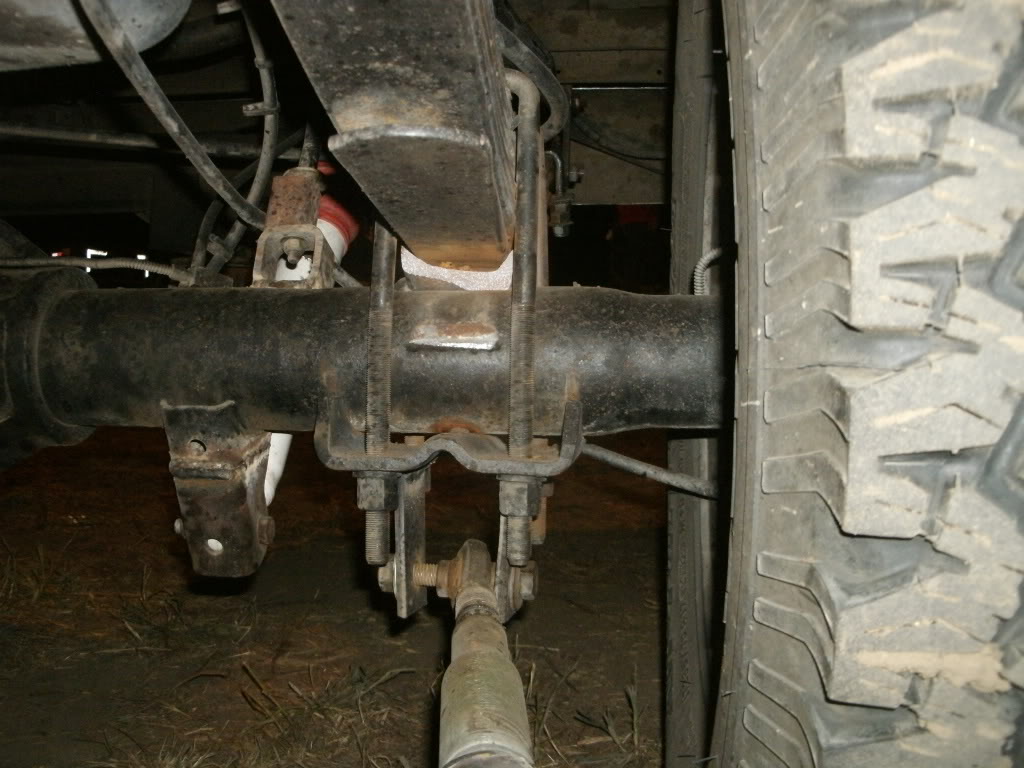

Welp really been livin up to my screenname this year.
Really tore it up good last night. Broke a traction bar frame mount which caused the axle to wrap up severly which in turn broke both spring perches on the axle, then with the crazy pinion angle it spit the shaft out when it ripped the straps off the yoke, it also broke both spring center pins and bent some u bolts.
However I ended up with a 3rd and a 2nd

Ouch. I always say I want to try this but seeing that makes me kinda glad they never have pulls here in this stupid state. Interesting shock location, guessing that has something to do with you pulling with your truck I can see how that would be better for axle bounce vs. The dodge "A" frame style.
Hope its all a fairly easy fix for you, good luck.
