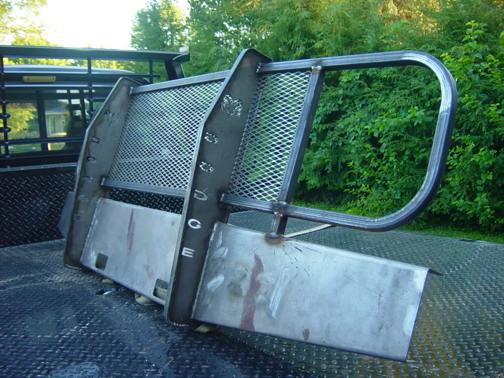

Heres a pic of the one I threw together for my truck.
A 100 lb speed bump took out the orginal bumper.

WOW! I like that. That is a very clean install. How is the bumper mounted? Is it White Tail proof? Can you PM me dimensions or material list? That would be a nice project for this winter. The only problem I would have is the radius bends in the tubing. But I know a shop that might be willing at a reasonable cost.
Old Dec 6, 2009 | 12:22 PM
Philip's Avatar
Posts: 1,090
Likes: 14
It is mounted to the same bolt holes as the orginal bumper. The uprights are 1/4" plate water jetted to size and made to fit into the orginal bumper mount area. The bumper is three pieces made from 10 gage or 1/8" steel whichever you want to call it. The square tube is thin wall.
The ends of the bumper are just capped off. The two small holes in the bumper are for driving lights. They are not installed in the pic's.

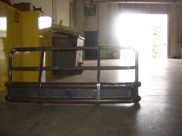

This is my old one. It used to look good!

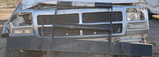

Here is mine that I threw together when I bought the truck. Its pretty sturdy. White tail and honda proven.

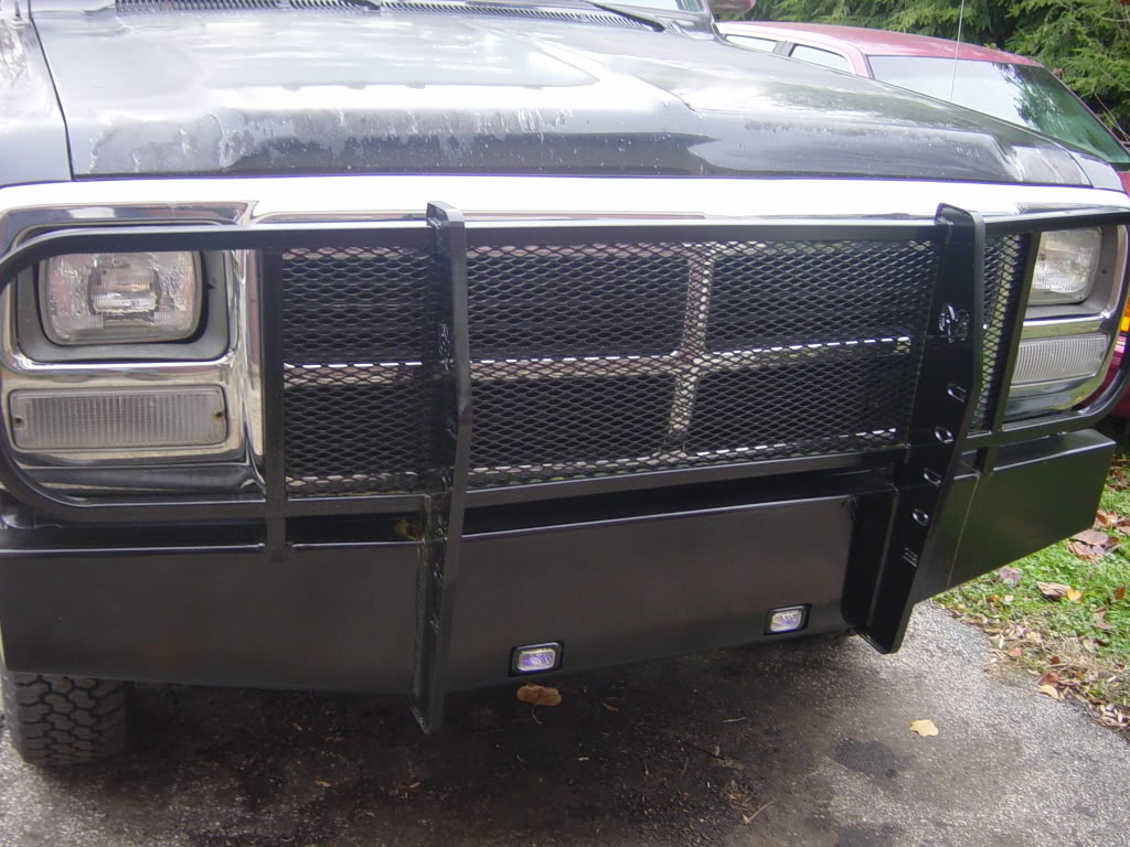

Here is mine on my crew cab.
