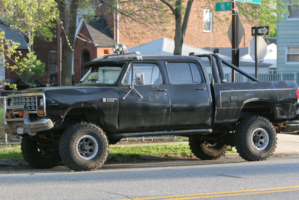

im looking for something like this:

Originally Posted by Jim Lane
...also unless they were specifically Roll Bars and were braced through the bed and into the chassis using steel plates and high strength bolts and were not just 4" exhaust tubing they are only Light Bars and have given many people a false sense if security because they are not really a roll bar just something that looked massive and cool for you to hang your KC lights on.
I live at the base of the San Gabriel mountains were people go off-roading all of the time and I have seen lots of especially lifted trucks coming down the mountain on the back of a flatbed with the supposed roll-bar collapsed into the bed or the roof of the cab.
http://www.sams4x4store.com/SmittybiltTruckBars.htm
Jim
**** good point! Alot of people call light bars roll bars, and don't understand the difference. In my opinion (and it's worth what you're paying for it) if roll protection is what your after, then you definitely something substantial, and attached through the floor to the chassis. The bars that you see in the beds, including the one in my pic, won't do much in a rollover, but make a different place to mount lights etc/.
