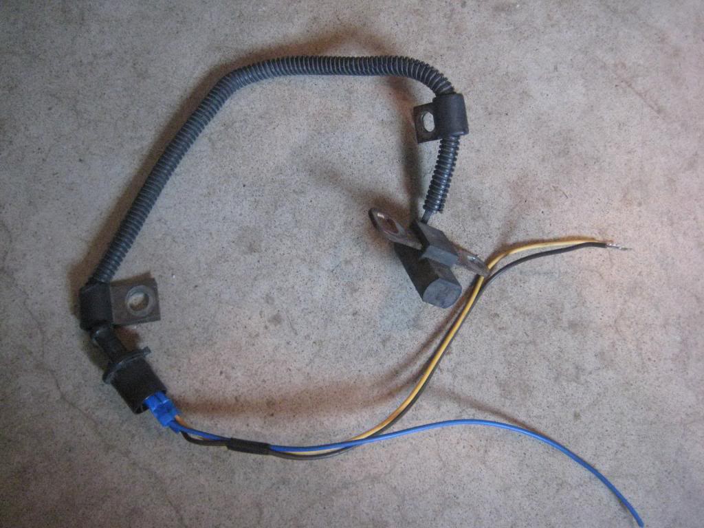

@ totallyrad , my CPS wires already have a nice plastic loom protecting them .
So I found detailed instructions on how to test the CPS which I found out from a Cummins dealer is actually called a speed sensor .
This picture shows how I connected the sensor to my harness .
Those are just 14 gauge crimp ons . They slide right over the sensor pins .
Black /Blue tracer is the ground . My ground is good
Tan/yellow is the power feed . I have 9 volts there which is within spec.
Gray/black is the signal . Only 1.3 volts here . It should be at least
5 volts when the sensor is on an air gap.
So I guess I'm going to order a speed sensor and see if it fixes my problem .

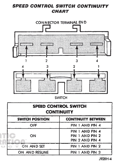

Originally Posted by truckerick
Update...
I installed the new crank sensor and now my a/c works again , I have the alternator hooked up without the external regulator and it's working fine , the only thing still not working right is the cruise control . I can set it but the speed gradually increases . Any one have experience with cruise that speeds up ?
Mine has a mind of it's own most of the time. I traced it down to bad switches on the steering wheel. Unfortunately they seem to be made of unobtainium, so I have to build up a rat shack substitute.
I hope to set up an overhead console for most of my peripheral stuff, and the cruise switches will eventually go there.
Here's the continuity test chart.
