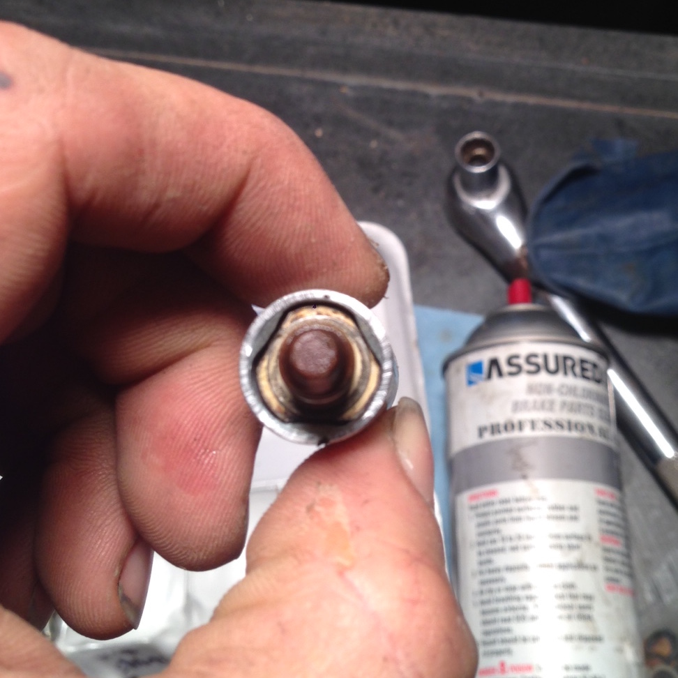

Instead of removing PS/Vacuum pump, which would have compelled me to reseal them both, I made a wrench to get the bottom nut easier I was able to make the bends exactly how I wanted to get as much travel as possible. Worked very well. So did the special socket I made. Turns out a 12mm is perfect. just round out three sides.

Very nice home made tools. I'm sure we all have a special drawer in the rook away with our cummins specific tools
