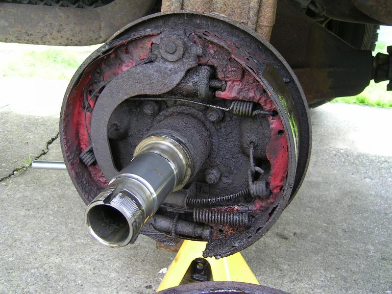

So I took off the old shoes. Man were those things done for! Same with the drums! I'm having trouble piecing it all back together, anyone have a pic of how it all reassembled? I also went to do the kip this weekend and it was gone!
Old Oct 1, 2014 | 12:33 PM
Before....

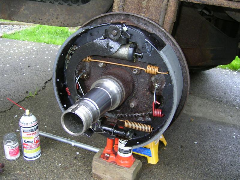

After....
