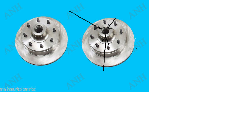

This is what is too small for the factory bearing, and a new bearing and dust cover is not supllied, nor is it even mentioned as an option.

Did you make sure to tell the parts guy it's for a 4,000lbs axle? I'm looking at rock auto now and the picture you posted is exactly what is shown under the 3,300lbs axle.
3,300lbs axle -
4,000lbs axle -

Told them 3000, the 4000 pictured a set for a 4wd. I will try that tommorrow though. Did all 2wd's have 4k axles?
Old Jul 29, 2011 | 11:27 PM
jimbo486's Avatar
Posts: 4,389
Likes: 114
The diesel 2wd's (3/4 or 1-tons) have the 4,000lbs axle, yes. Gasser 3/4 and 1-tons have the 3,300lbs axle.

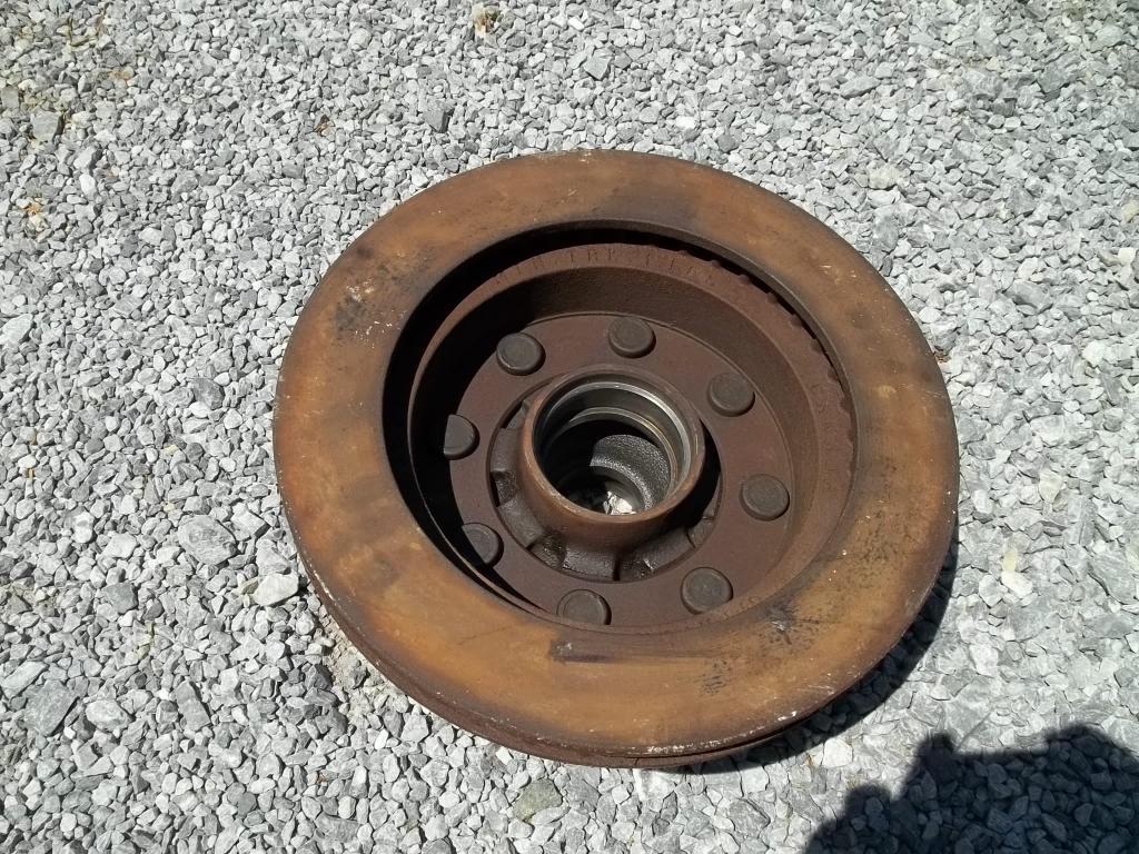

took these off yesterday.they were on an 1990 d250 diesel.if you want bearing or seal numbers let me know.all the diesel 2wd have 4000# front axles.want pictures of spindles?

those are the rotors I need! if you have a pn for them that would be great. I don't know whats up with the smaller bearings on the set I bought

did a quick cross check for you.wagner BD61915 is for the rotor only.that was crossed with rockauto and advanced auto parts.came up the same.do you need just the rotor,or rotor and hub?they come apart.
