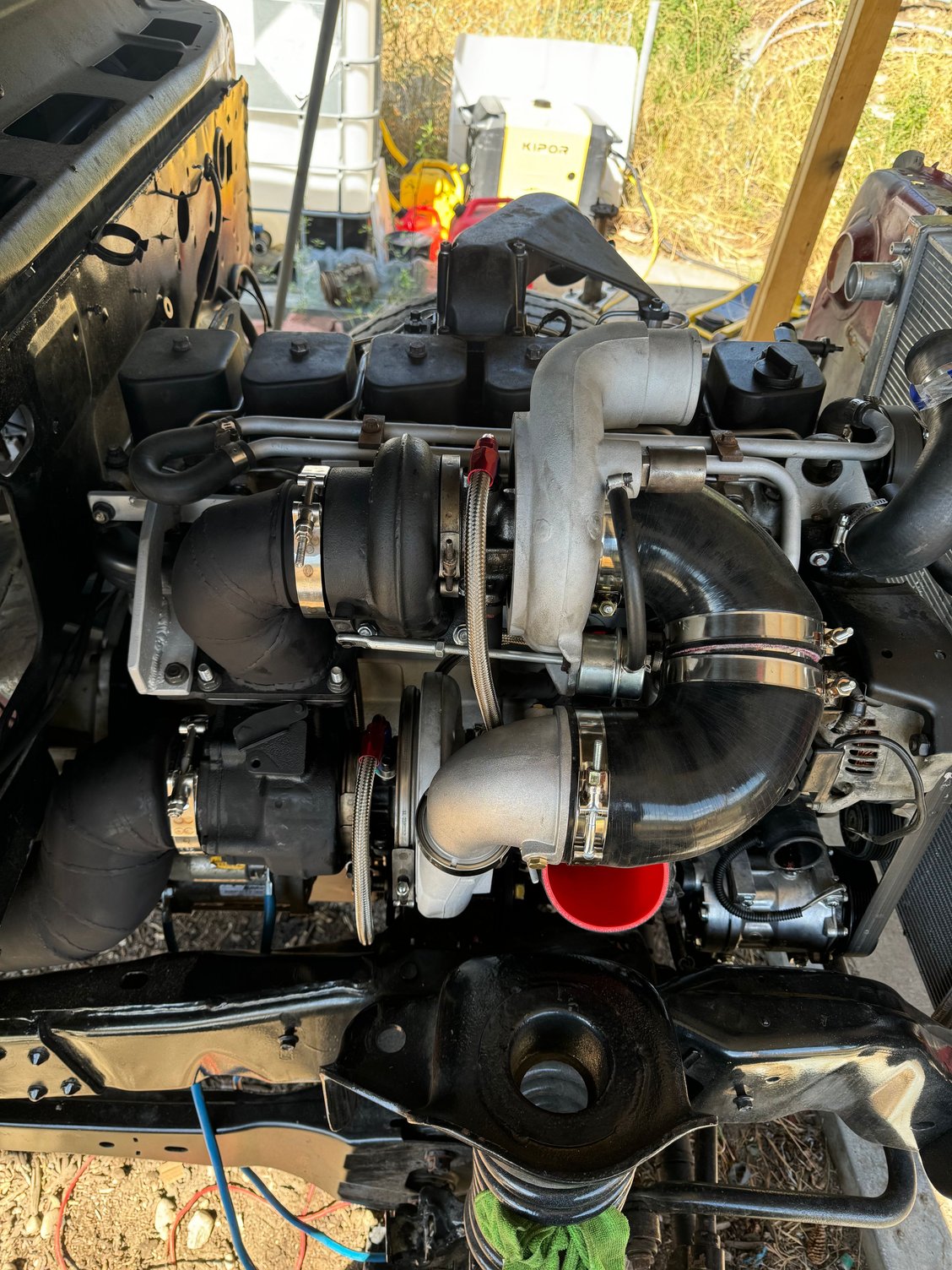

Old Aug 28, 2024 | 11:57 PM
  #75
MoPowa's Avatar
Posts: 574
Likes: 143
From: Kelowna, BC
Compounds are starting to shape up.
