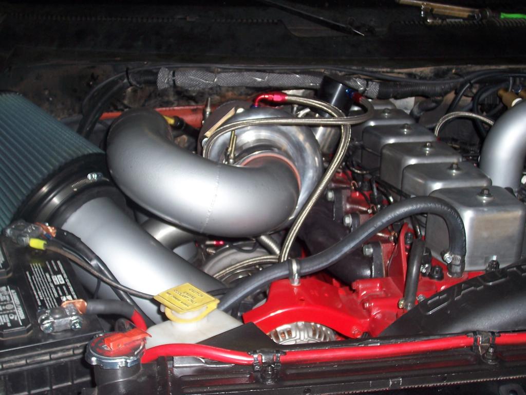

Originally Posted by SKATERHAULER
Anyone make taller valve covers ?
A buddy made these and it's expensive but they look nice!
