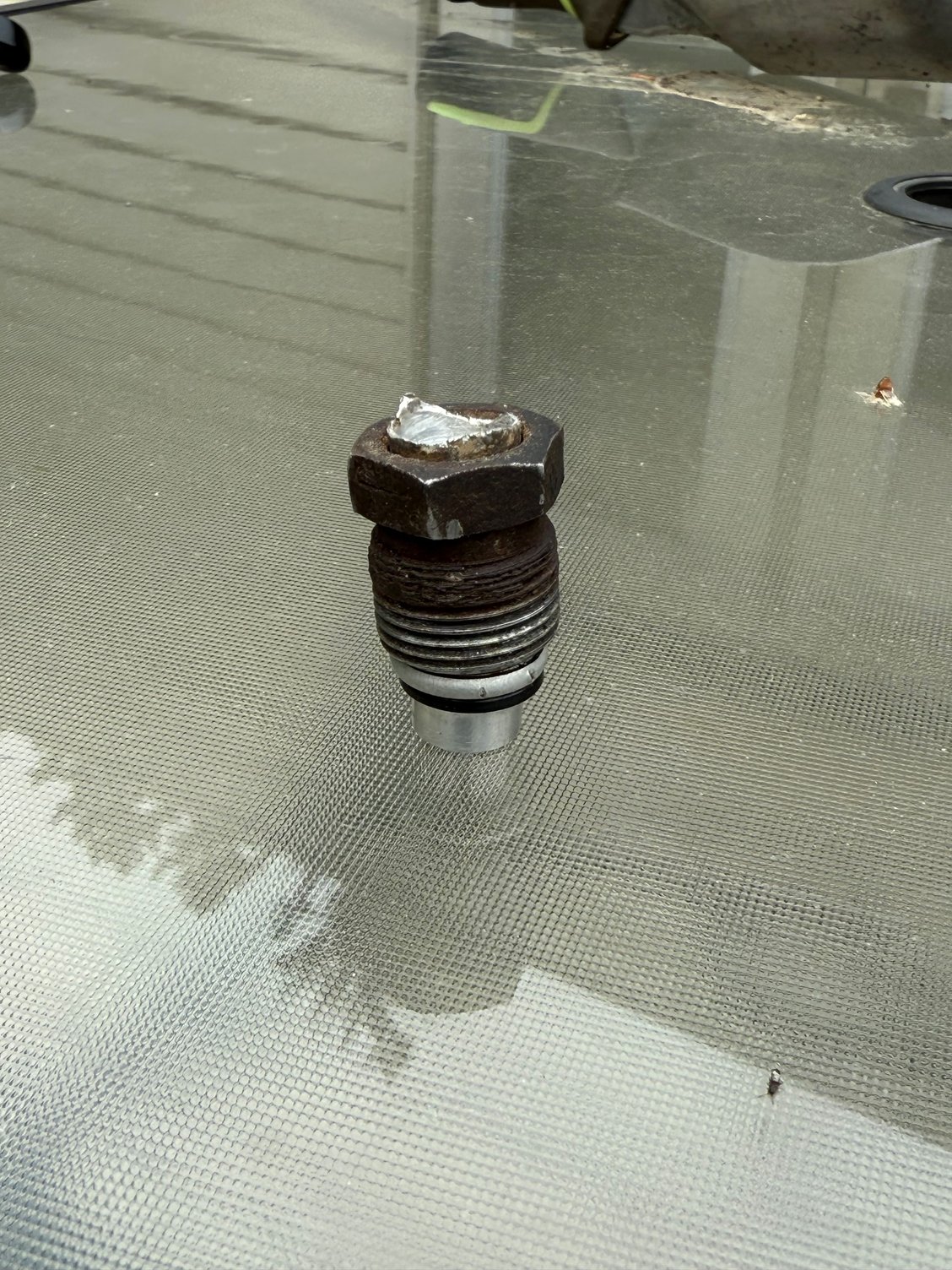

It’s a 93. It’s neither flared, nor a quick connect. I’ll get a picture later. I’ve been in the industry for 35 years and haven’t run across a fitting like this before.
Old Jun 21, 2025 | 01:16 PM
Timmytorco's Avatar
Joined: Aug 2022
Posts: 64
Likes: 20

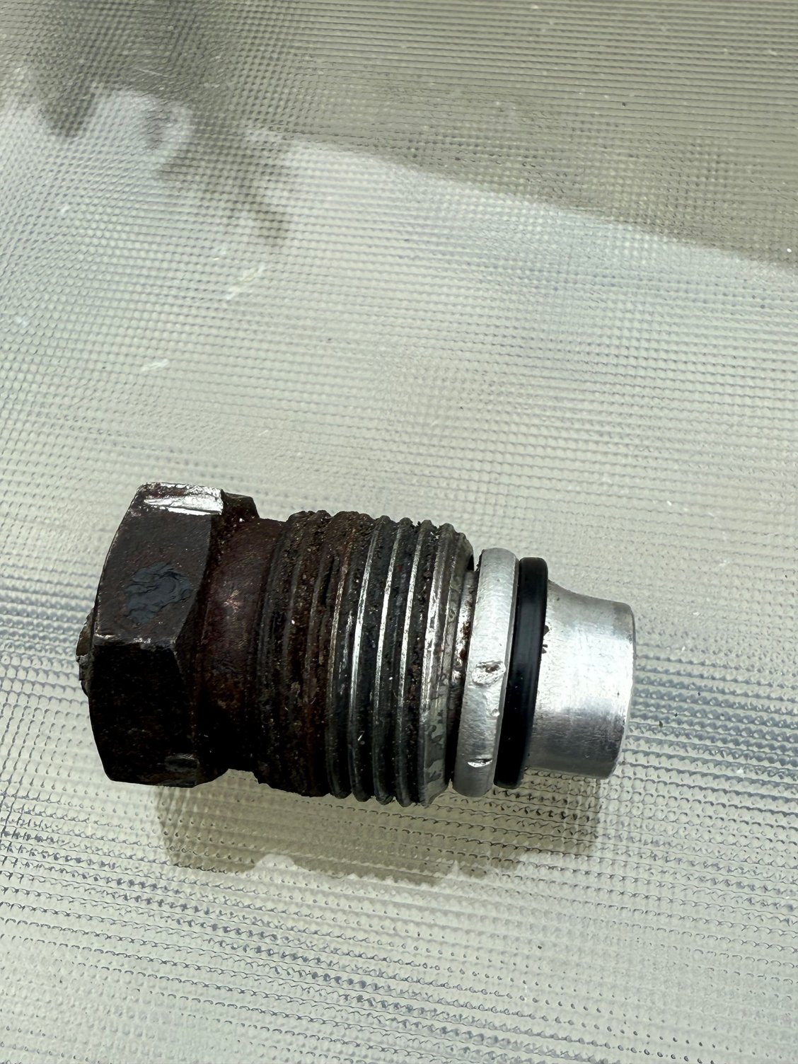

Here’s a pic of the end that broke off right at the cooler. I’m guessing vibration and galvanic corrosion were to blame.

Looks a lot like the fitting you would find on the ends of a power steering pressure line.
Old Jun 22, 2025 | 09:27 PM
Timmytorco's Avatar
Joined: Aug 2022
Posts: 64
Likes: 20
It does. Where do I find one in northern Saskatchewan is the problem. They’re 1/2”. Haven’t found an application with a 1/2” ps line. I can’t believe the internet doesn’t have a solution to this that I can find. I’ve ordered a new cooler with npt ports. Unfortunately it won’t fit behind the grill as I have a 74 body on a 93 frame.
Old Jun 22, 2025 | 10:35 PM
pind's Avatar
Joined: Jul 2004
Posts: 1,252
Likes: 52
From: Whitehorse, cultural hub of the universe..
If there is a decent hydraulic shop in the area, pa/nip/lloyd, they should either have the fittings, or be able to access them. Most common for that fitting is gates, followed by weatherhead, then new line/green line. Most of them will be crimp fittings for hydraulic hose, but that works too, just have a line made up to your specs.
