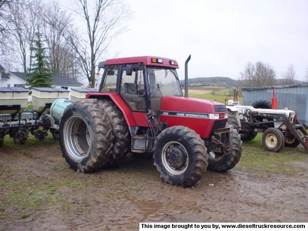

Our case tractor has a 3.9 with no grid heater , comes standard with an either start button , but it has to be REAL cold in order to need it , generally when it is that cold we plug it in. In the 5-6 years we have owned the machine we have not used half a can of either on it.

clutch1's Avatar
Posts: 1,079
Nice tractor JKM. Whats the model.
