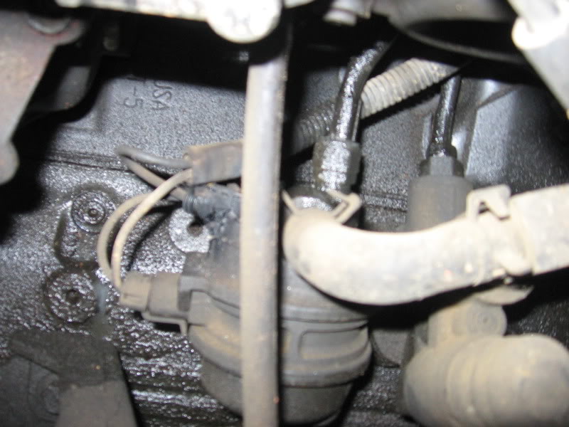

here is a pic. of one of the problems. Look at the wire going in at the top left.

Unless you live in the arctic there is no reason for the fuel heater.
Deleting it is very easy, you find directions here http://www.cumminsforum.com/forum/94...m-writeup.html
