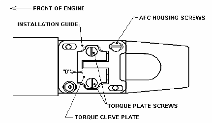

i pulled mt afc housing to discover no plate, i got a ten plate to put in, dose the profile point to the front or back? thanks in advance

the profile goes to the front and center the plate in its slots hope this helps cliff

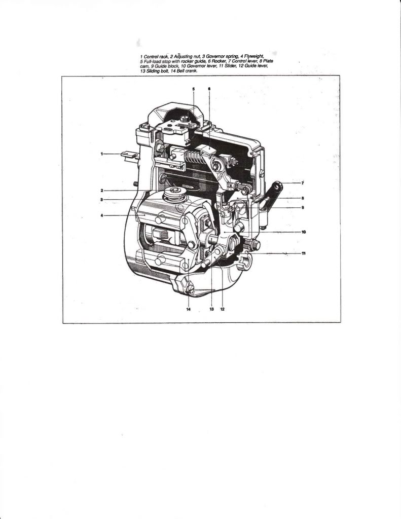

Sure about that Cliff?

Wrong.. Plate goes in as Bill has shown... Profile faces toward the rear of the pump.
There are more photos and instructions here...

k thanks guys those cutaways really helped and its got a lot less smoke thanks
