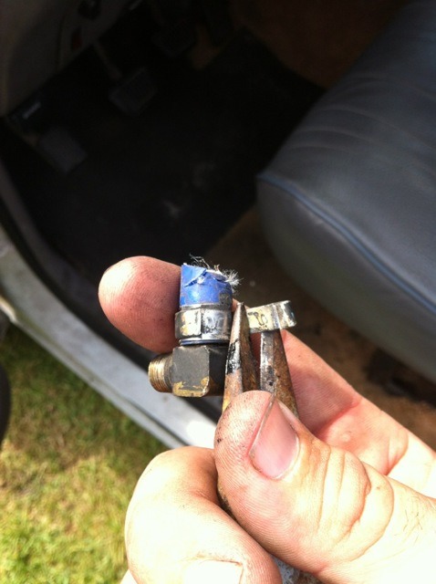

Well apparently it's not an issue because I am pushing a whopping 0 psi! I pinched the return line just to make sure the gauge worked and that got it up to around 60psi, but as soon as I let go its 0. I just put a new lift pump. Do you think maybe it went bad or can something else cause the missing pressure? Did I tune up the IP so much that the stock lift can't keep up?? Forgot to also mention I have a 16 degree timing advancement.
Attachment 39583
Fuel gauge is left, oil pressure right.
Attachment 39584
Old Jul 9, 2012 | 10:24 PM
patdaly's Avatar
Posts: 8,372
Likes: 172
From: Streator Illinois
Attachment 39583
Attachment 39584
Overflow valve, replace it.

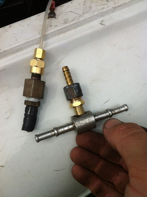

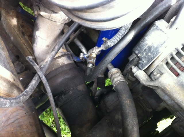

You guys have been so helpful that I'd like to ask another question if that's ok. While I was hooking up gauges I finally hooked up a turbo boost gauge by teeing into the waste gate line. However I'm only getting 5psi even at highway speeds. When I put the petal down it climbs to 8-9psi and the drops quickly. I also tried pinching off the line with a clamp and saw no difference. Is this acceptable? Thanks.

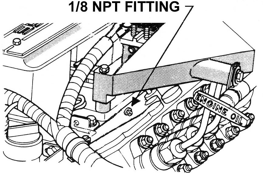

I'm not sure how accurate it is to tee into the boost reference line.
I'm sure that this works though:

Yup the way infidel shows is the way I did mine.
My stock motor generally show very little boost unless pulling hard uphill, Then gets as high as 22.

Last night I hooked up the boost gauge the way infidel showed. Driving around town gave me the same reading. I accelerated hard, but could only go 45mph. Never got over 7psi. I'm taking a highway trip later on today, and I'm leaving the wastegate line pinched shut. So we will see what that shows.
