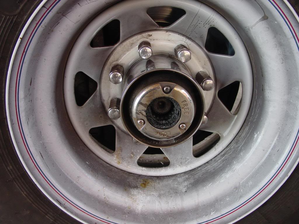

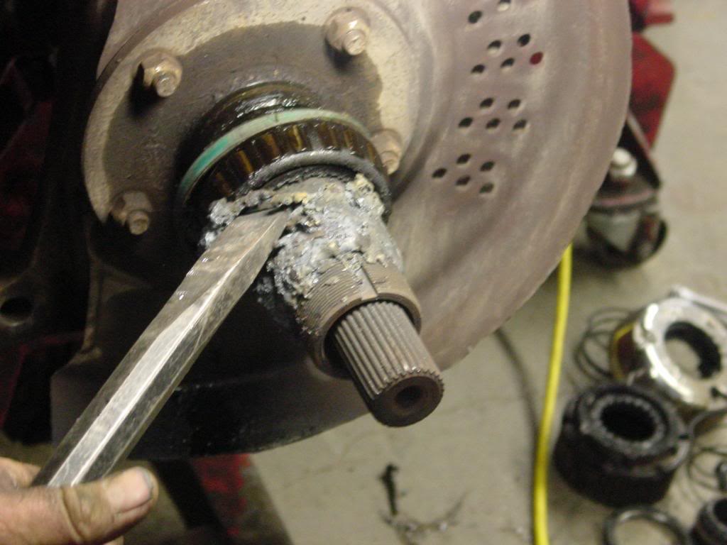

I should check for play in my CTD hubs, as I know all to well what can happen to ill maintained hubs! A decade ago a friend and I were driving from VA beach back home to Oregon in his fairly new at the time Power stroke, that he used off road plenty- and we lost a outer hub berring- it pulled so hard when it locked up that we nearly wrecked at 75mph! then everything felt ok again so We drove it to the next service station and noticed people freaking out as we pulled up to the pump- the plastic 4wd locking hub was on fire! Thankfully a local Ford dealer (Fremont motors in Rawlins WY) got us up and running in one day-
