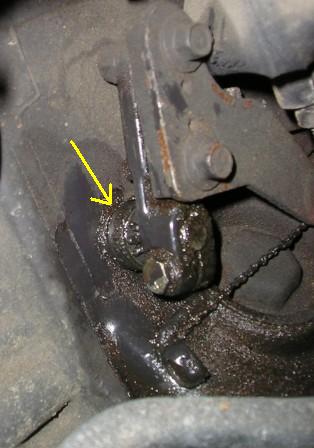

There is a plastic piece (arrow) that wiggles and spins when I poke it with a screwdriver. Is this normal, or could replacing this help?

I dont think that would help...I wouldnt worry so much about the leak - I would worry more about what could get in.
Its by no means critical to pump life, and cant be caused by ULSD. Its on the engine oil side of the pump, not the fuel side of the pump. The spinny plastic thing is normal and replacing it wont help. The only downside of driving it leaking is you will get a nice undercoating on the bottom of your truck
