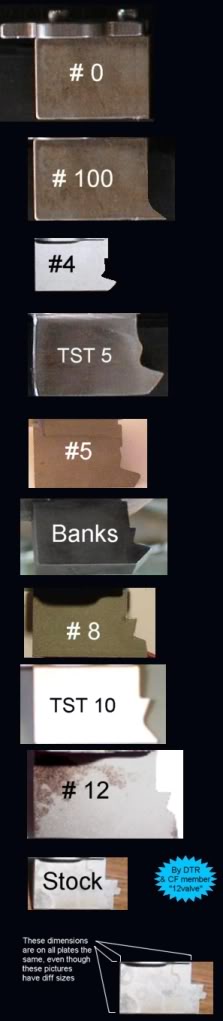

Who are some good guys to get the 4k gsk kit from?? I thought I remember some actual size plates that you could just copy and trace on your stock plate, any idea if those are still around?? Thanks.
Old Apr 7, 2009 | 07:49 PM
infidel's Avatar
Posts: 14,672
From: Montana
Do you mean like this?
Tracing is a bit more than is necessary. It's not rocket science.

soo what are the plate characteristics (0, 10, 100, compared to stock)
which one is the best?
Old Aug 7, 2009 | 07:31 PM
infidel's Avatar
Posts: 14,672
From: Montana
It all depends on what you want to use the truck for.
