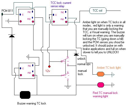

From: Denmark
I had a guy at work who knows about relays and such make me a setup that locks with a switch, and unlocks with the brakelight.
I have no idea how it works, but I really like it.
Slev
Slev
Like this?

From: Denmark
Not like that, it´s a relay that locks it with a pushbutton, and another relay unlocks the first relay with the brakelight, no buzzer or lights.
Slev
