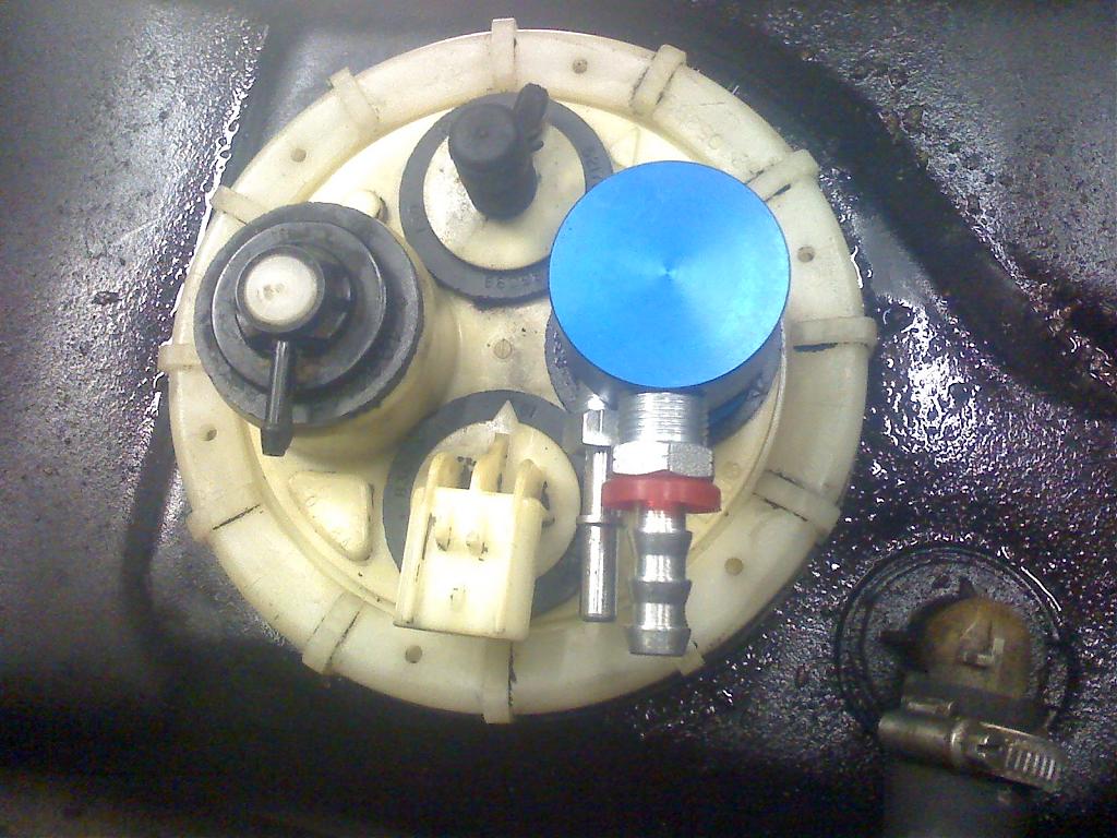

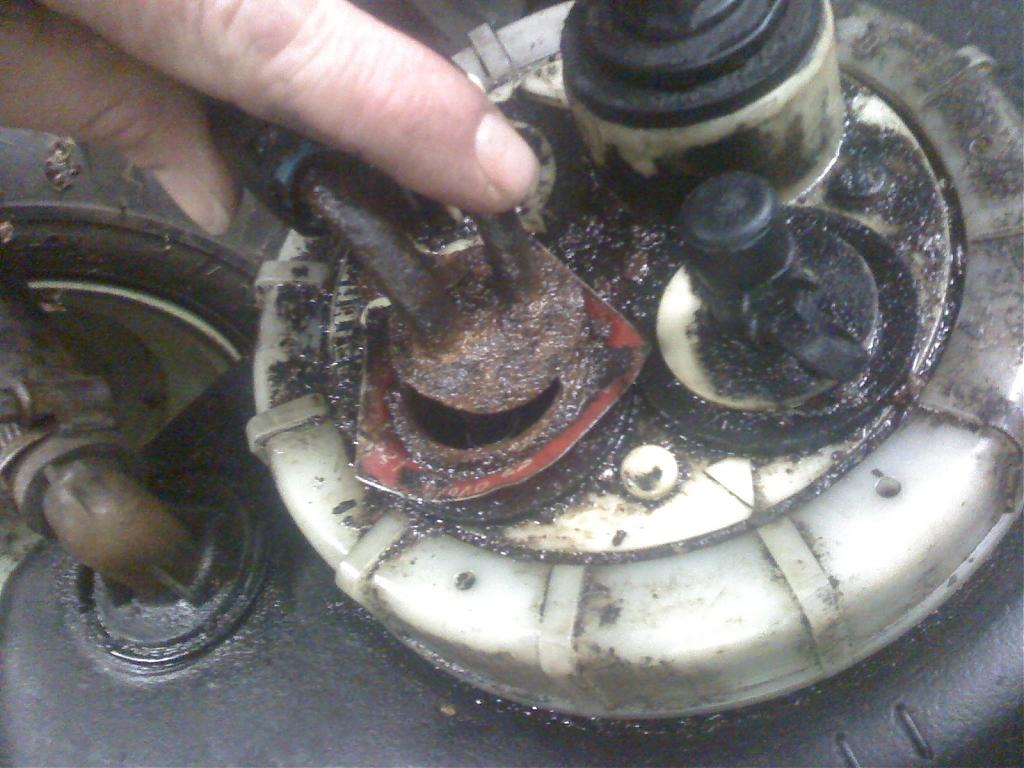

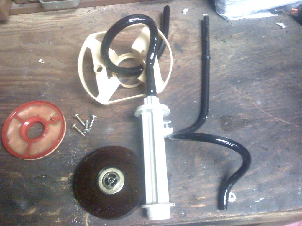

I just the other night installed a drawstraw1. It is the new model. It fits in the original spot that you describe. My old lines did the same as yours-including the quick tabs on the lines. I just cut off all the flex line and used fuel line instead. The mod to the sender is a bit more then slight. Everything in the modual is removed. the screen on the bottom stays. I messed up on the order and got the ridged line. It works but tilts the drawstraw "head" a tiny bit.
Old Oct 27, 2009 | 11:11 PM
biododge1's Avatar
Posts: 427
From: illinois
Heres some pics for ya....The last pic is all the stuff needed to be removed.
