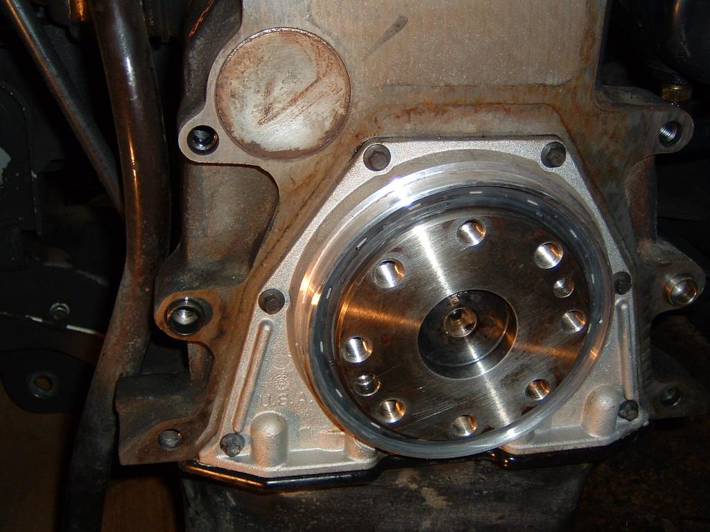

May have screwed the pooch .... Not sure if I drove the seal too far in ... I used the seal driver with the top hat side in ... it fits both ways flush or in ... The seal that came out was a little different then the one installed .
I drove it flush with the hat side in ... looks like its riding in a different spot on the crank .
Heres a few pics ... Let me know if I should go get a new seal ...LOL
