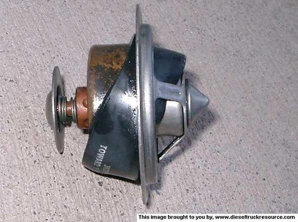

Quite common for the rubber seal on the stat to come off and get stuck holding it open.
I've found just removing the seal entirely and tossing it doesn't effect anything except allowing the stat to close.

If your temperature gauge isn't moving much it could be a stuck thermostat. Mine T-Stat was stuck open because the rubber seal had broke and got sucked down into the T-Stat and was holding it open. Pete

This is what Infidel is referring to…My 1997 had the same symptoms and this is what I found.
T-Bone
[IMG][/IMG]
