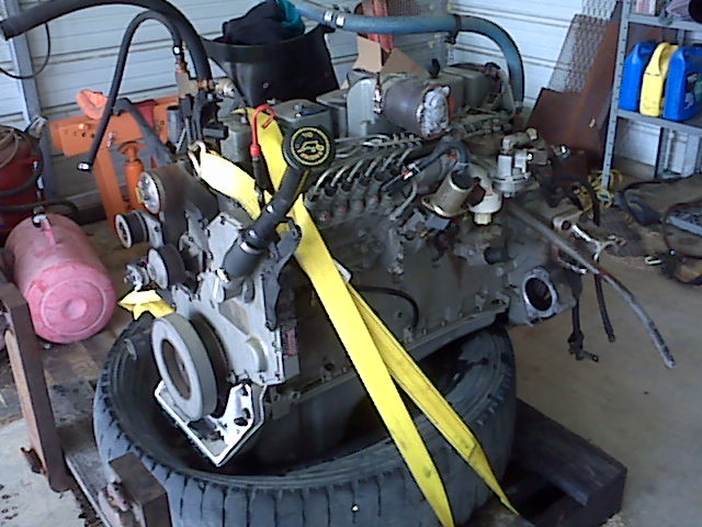

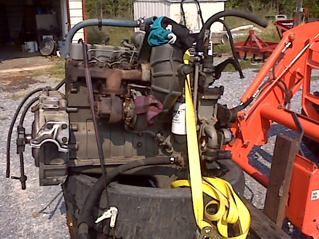

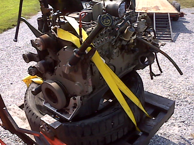

Pics of engine.

Old Sep 8, 2009 | 08:04 PM
Bluedually4x4's Avatar
Posts: 281
From: Twin Falls Idaho
Pretty sure the engines are the same except for the horse power rating, the 5.9 is in thousands of diesel powered stuff.
