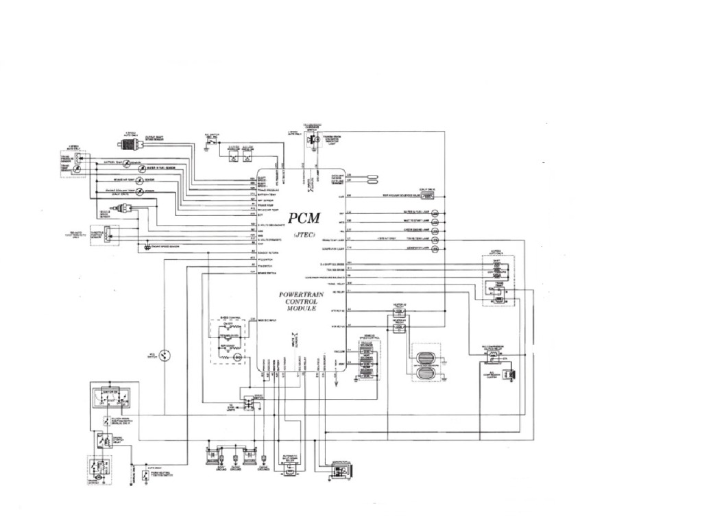

Still sounds like the ESS is bad.
Sad but true, many new parts are bad right out of the box.
Hope you can read this.
What you need is called the Powertrain Diagnostic Procedures manual. The DPD is for the electronics only and was only $10 new from Chrysler but is now out of print.
See them on ebay all the time though.
