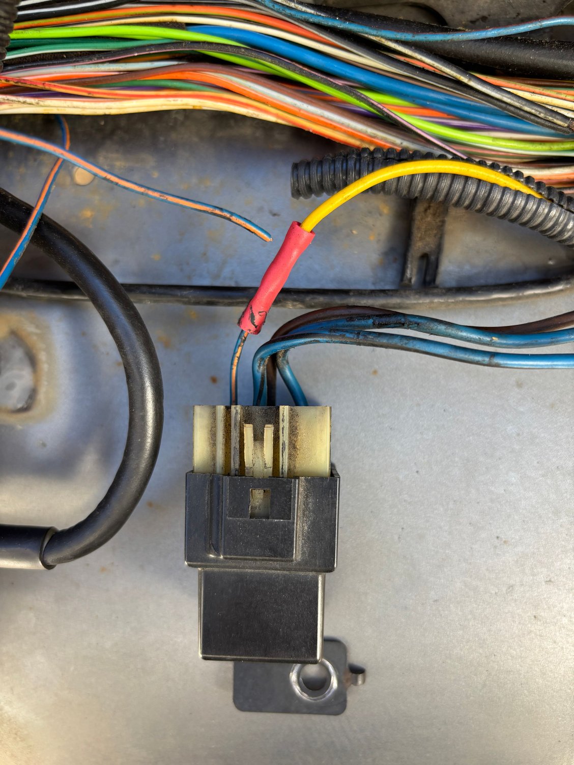

Hey guys, so the other day I removed my driver side fender and noticed a little shade-tree wiring done by someone that was not me.
There’s a very thin factory wire (blue/orange tracer) that appears to have—at one point—gone from the main harness from PCM all the way the through to AC/Clutch relay. Well, it was just snipped about 2” short of the relay, and the remaining wire was butt-spliced with a random, thicker yellow wire that runs across the firewall harness where it is butt-spliced with a brown wire that runs (along with 2 blue wires) into the connector for what I can only find to be the heater/AC cycle switch or suction switch.
What are the benefits of doing this to the truck? Or is there a common gremlin they were bypassing? Any help would be appreciated.

Someone bypassed the PCM. Why I can't tell you. PCM may have burned out. You could reconnect to find out.
This is a ground signal. You may want to see this thread to add a thermostat between those wires
i’ve got re-hooked up like it originally was I had a new PCM installed or a rebuilt one from a reputable company. What does the a/c cycling switch do?

Regulates temperature and keeps the evaporator from freezing up into a huge ice cube.
