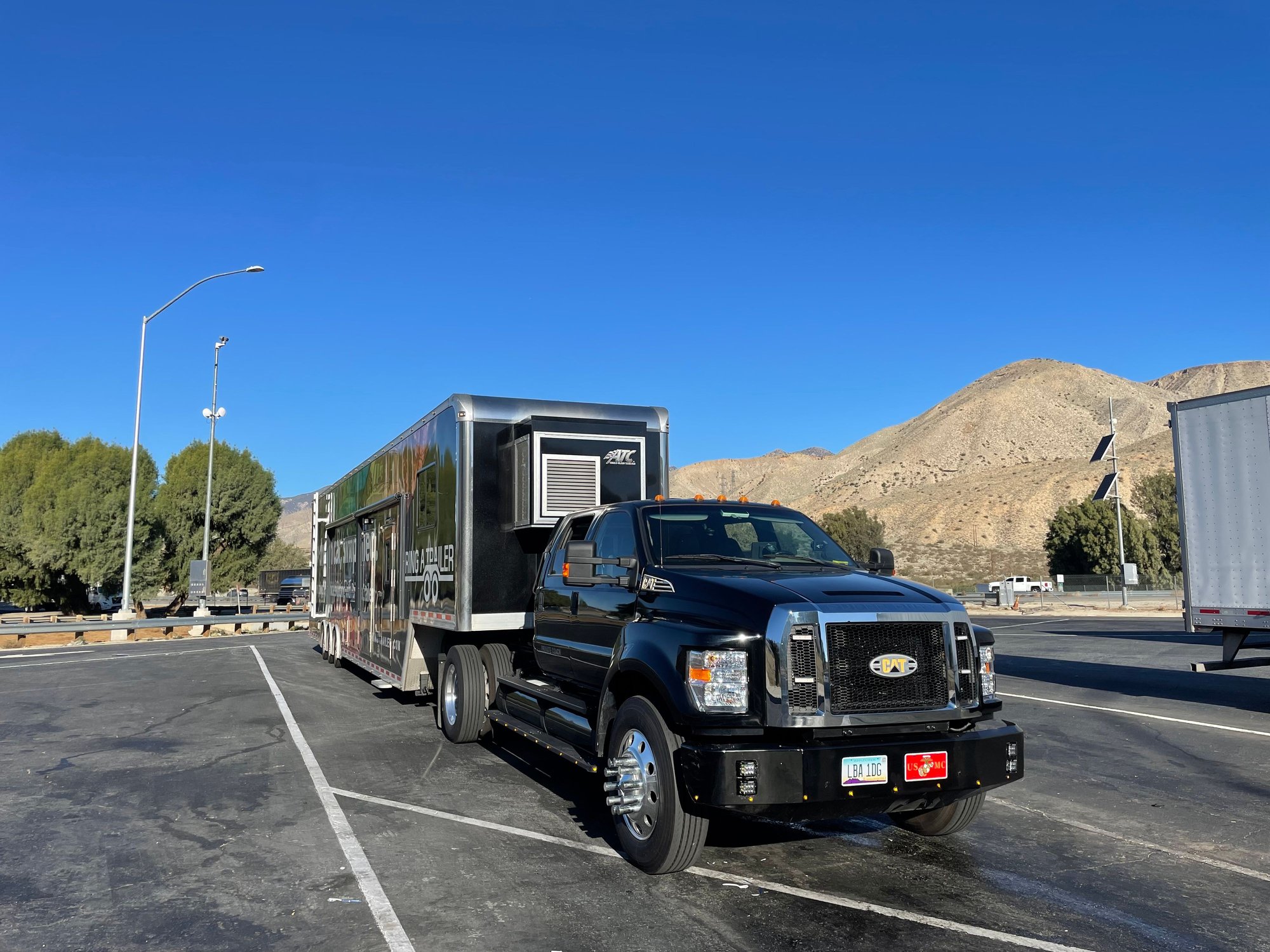

Hey guys,
I am not sure if this has been addressed but I wanted to get your input on the 12V swap for my CAT 3126b. There are a couple things at play here; the 12V has to mate to an Eaton Fuller 13sp and have a compressor. As far as I know, I will need to yank out the 3126b, ECM, and complete wiring harness. Sounds like a lot of work but this 3126b has to go. My 750 works over the road and pulls
Hauling exotic cars over the road
roughly 58k pounds and it barely makes it up the hills. The current configuration is 230HP and 800 torque with a PDI tuner, turbo, and exhaust manifold. I would love to hear from anyone who has done this swap or has definitive knowledge of what’s required. Thanks in advance!
John
