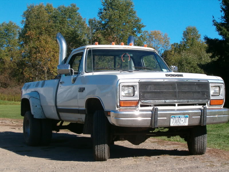

It was originally a w250, single stack and white. When my buddy wrecked his d350, I swapped the rear and bed onto my rig. Ran a tailpipe for a while and dual 6'' stacks, but don't think I ever ran the single with the dual wheels. You from this neck of the woods?
Old Sep 2, 2009 | 11:07 PM
G1625S's Avatar
Joined: Mar 2004
Posts: 4,767
Likes: 5
From: port crane, NY
srw:
DRW:
Thread hijack over
