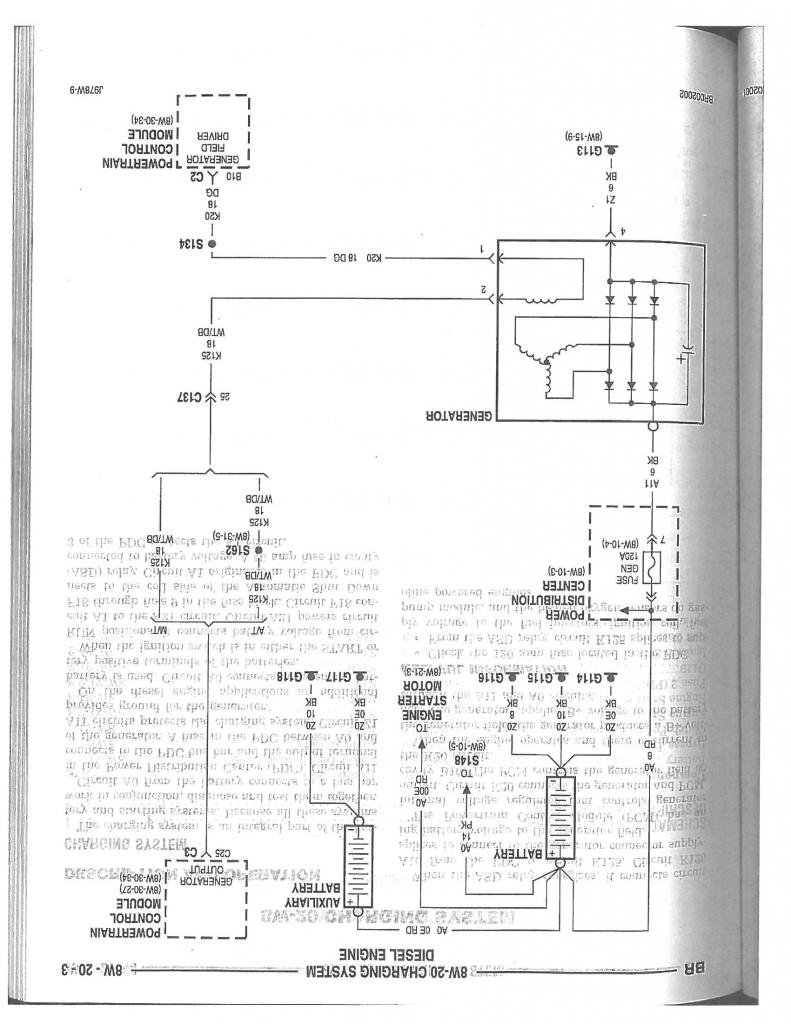

Ok, going thru my 97 FSM, this is the first year charging voltage apply did not go thru the ASD relay, should help us a bit.
First thing they do is ask for a physical inspection, which you have done, next is to see if any codes were thrown, did the check engine light come on? Might not hurt to take it to AutoZone and have it scanned.
They have you test the cables, engine running at 2400 RPM, touch negative of your VOM to the + side terminal of the batt, and then the + side of the VOM to the B+ terminal of the ALt., if voltage is below .6V, you are good, if above, check for corrosion or bad connection or wiring. Then they check the - side Touch the - side of the VOM to the negative side battery post and the + side lead to the GROUND TERMINAL of the alt., this is the nut that attaches the field terminal block to the Alternator case ( NOT the field terminals themselves ) You are looking for less than .3V, if more, figure out the problem with the ends or cable. Looking at this, and going back over your problem, I am not so sure you didn't fix this thing right when you took the negative terminals apart......... Anyway, if all that checks out, it gets more complicated to test further, I would probably get the 35 dollar FSM on disc from genos for a 97, it will more than pay for itself........
I will look for the wiring from the fields to the PCM for ya......
On edit, here ya go.
98 12v Not Charging/Gen Light Out Of Town-97-alt-pcm.jpg
