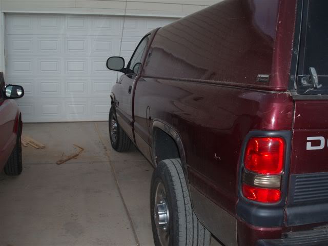

Originally Posted by West Coast
Johnh I need to drive this truck in the snow so that is the main reason for needing a single axle in the rear. What type of rims did you run in the rear? Any pictures? Are the inside dually wheels at the same width as the front wheels of the truck? I am going to look at the 94 Dually this week. So I have no actually seen the truck in person.
'04 17"2500 wheels and a 2500 bed

John looks like the rear tires stick out just a little more than the fronts?
Thanks for the picture..... (:
