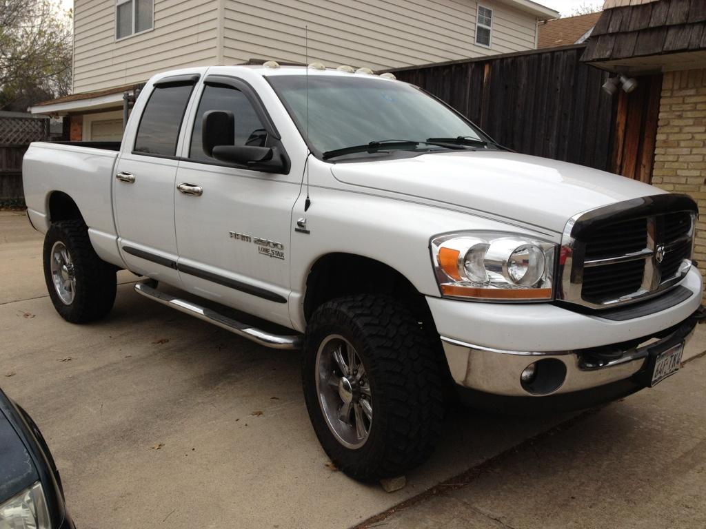

Crobtex was talking about trying to get something together here when it warms up in a few months the other day. We went up and ate lunch with RJ the other day....
Oh yeah.....I'm back in the game:
Nice looking truck! And that's a sweet parking brake.

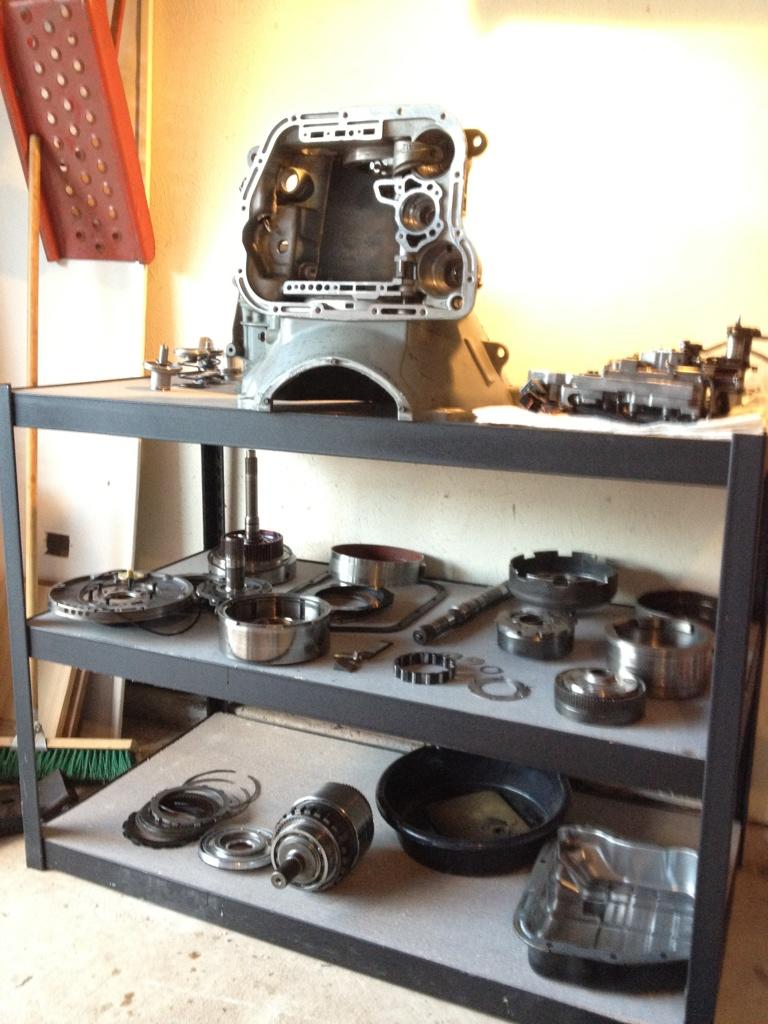

Yeah.....well...it came with a catch:
I did pick it up cheap. And looks like I'll be able to get out without putting too much more into it. It's got a Bank$ exhaust, intake and 6 Gun tuner...(will be selling the tuner and looking at some EFI Live) and a billet Suncoast tranny. Issue was the flex plate let go and allowed the torque converter to snap off one of the dogs on the Fnt pump drive. Repair torque converter, freshen up the clutches, o-rings, seals and bearings; put a new pan and billet flex plate....should be golden!

The deal had the disclaimer
**SOME ASSEMBLY REQUIRED

That is a good looking truck. Not a big fan of white but that's looks clean.

Congrats on the new ride Dan! Very nice!!

Thanks Robert...told myself I would never have a 3rd gen.....but this too good to pass up....
