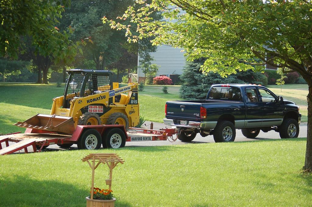

Rented this last week to do some grading in the yard. Man you could definately tell I had something on the back of the truck!! What kind of weight are we looking at? have no idea.

You can get on the manufacturer's web site and it will tell you how much the machine weighs. We run skid steers at work but I can't tell from the photo how big it is. The trailers should be around 1,000 pounds.

It does help when I click on the picture. From Komatsu website, 5785lbs.

heck that setup weighs less then my trailer or my 325 jd skidsteer

5,785 lb for the skidsteer and about 1500 for the trailer. I have the 1020 and that thing is about 2000Lbs heavier than the web sight says

Trailer is about 2000lbs or more, skidsteer 5800 I would say you had 8000lbs on your hitch. Inflate the tires to full pressure, it will help a lot, also be sire they are at least E rated. A pull behind will feel much worse than a gooseneck/5th wheel where a lot of the weight is on top of rear axle and some on front too.
Next time keep looader a little back from tongue, let the trailer take some of the load but not too much, I see that tariler has at least 6000lbs axles, so it's heavier duty. Around here the rental place sends you home with a trailer with car tires... , many times I made them understand if they blow, I will call them a have them fixx it on the spot, I am not going to do it for them.

yeah, look what he's pulling it with!!!!

The trailer had dual 8 lug axles and e rated tires
