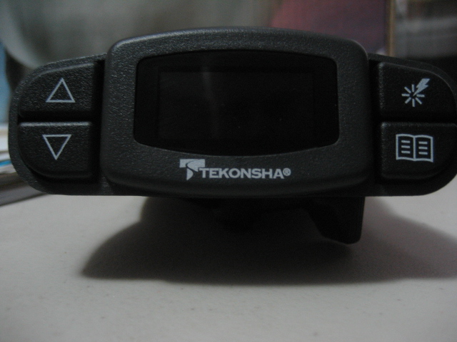

No problems with the new P3 I recently hooked up. Just had one trip with it so far but the trailer brakes smooth. Still playin with it a bit.
A nice unit.
