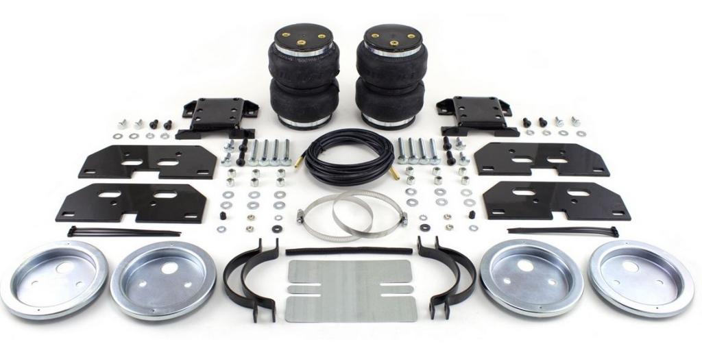

this is the AirLift loadlifter 5000 kit I installed last night and today, is this what you mean by double belows?

Old May 12, 2013 | 08:39 AM
  #40
AirLiftCompany's Avatar
Starter Sponsor
Joined: Jul 2011
Posts: 180
Different applications use different bag styles.
