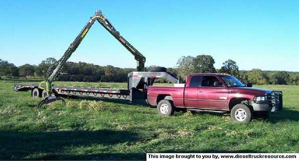

Ok... If you plan to use a trailer as well >>> I don't see why you don't solve the problem by mounting the rig to the front of the trailer as it would be much easier and safer to modify than the truck... Also... If the unit is suppost to be removable from the truck >> Then there are some definite weak points associated with that... Is the truck going to be used on the highways or public roads??? Or all off road at low speeds?
I MSPainted an example of what I think of when I imagine this rig... I will post it later... BTW>.. Thanks to Aggie Justin for providing a great photo for me to use as an example...... It is in the photo gallery pending approval...
OG
OG
Great photo Justin. Like I said before it's manuverability that is the problem when you have to take a trailer into the holes I get into. Not enough room or like in Jasons picture his boom can't reach behind the trailer so it's not any good unless you get beside what you need to load. If it's mounted on the truck all I have to do is get the rear of the truck within 20ft of what I'm loading. Sometimes that means reaching over a fence at the rear of the truck or down a hill behind the truck. Wouldn't want to try loading on a side hill. I had to unload a log tuck once on a side hill because it got stuck, not fun. If you looked at the web site I linked they just mount their's to a square trailer tongue.
Justin how did you fun the hydrolics?

Oh.. He doesn't have one on his trailer... I used his picture and stuck the loader on it with paint to show what I was thinking.... He had a John Deere tractor on there... I just erased it and put the crane on it....
It turned out better than I thought it would though....
