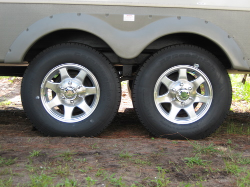

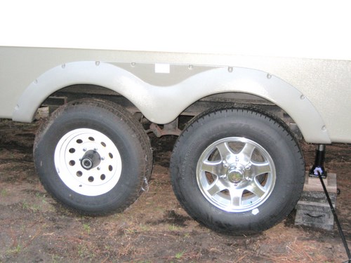

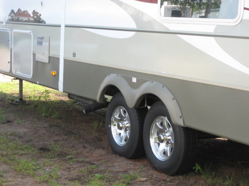

I got the new Sendel 7 spoke aluminum wheels and BFGoodrich Commercial T/A 215/85r16e tires mounted on the fiver on Saturday. They look real good and I'm looking forward to seeing how they handle and track. The 215 is 1/4 inch narrower than the 225 ST's I replaced. I went with the 215 to insure against the top of the taller tire touching the slide bar mechanism. This tire is being used by another person with the same brand of fiver as mine with great satisfaction. PCM

Thanks for the compliments. The aluminum wheels are from Sendel and rated at 3200lbs and 110psi. The center hubs are stainless with a removeable cap to allow you to use the easy-lub grease fittings.
I have seen the Domani, too. I very good looking rig, however, more of a party coach than anything else. Low cargo capacity and the wheels and tires you saw are an expensive option.
I appreciate the torque tips. I figured as much and I will be sure to do so. My first trip with the new shoes is the weekend of he 25th and is only 160 miles round tirp. So should be a good trip to do some retorquing.
I feel pretty comfortable with the new set up especially since no mods were necessary fo the fitment.
The only thing I had a really hard decesion with was going with the 215 vs 225. I felt I could not chance the taller 225 and its proximity to the slide room bar. The 215 is only 1/4 narrower. The positive of that, I guess, is less lateral scuffing on the ground on those tight turns. I hae not heard any problems of sway with the 215.
I will post some pi of the rig itched up within the net 2 weeks. I should have raised the rear of the trailer about 1 inch.
Hapy travels. PCM (PHILLIP)
