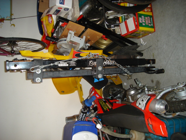

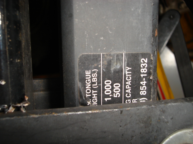

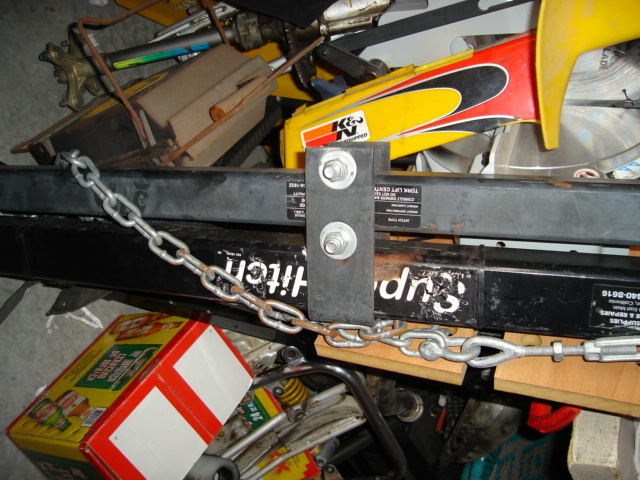

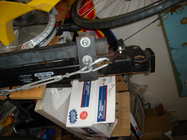

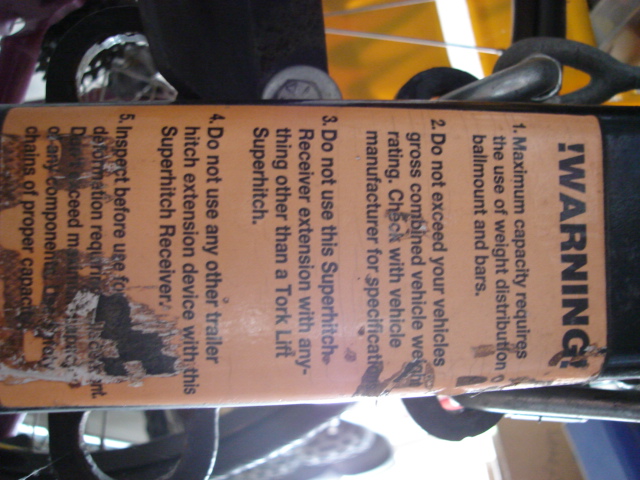

UMM, why? As long as you use a good "high weight rated" hitch extension and the appropriate hitch mount under your truck you should be fine. Here are some pics of my "superhitch"
