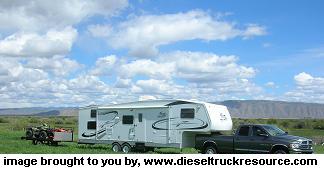

I pull this about twice a month in the summer and have not been bothered (knock on wood).
It's 75' 9" nose to rear.

wow thats a big rig we have been at about 63 feet with our current setup
hoping to upgrade the 5er to a slightly plusher unit
