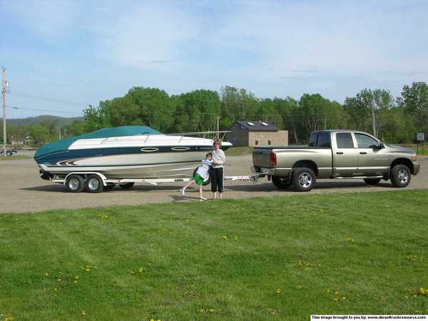

I tow this in the summer. The boat is a 24' and weighs somewhere around #6500 empty, the tongue weight is around #600 (10%). Runs fine down the highway, winds, hills ( Illinois & Wisconsin hills ) no problem what so ever.. I do not have a WDH and doesn't need one for me. But the boat has a 70 gallon tank (just behind the last axle)and if it is more than 3/4 full it will want to oversteer just slightly. But I think it's kind of dumb to drag that much fuel down the road anyways. Sounds like your trailer would be somewhere less than mine. Just watch your tongue weight and you will be good to go IMO. Now if it ever warms up here I can get it out again this season ..
