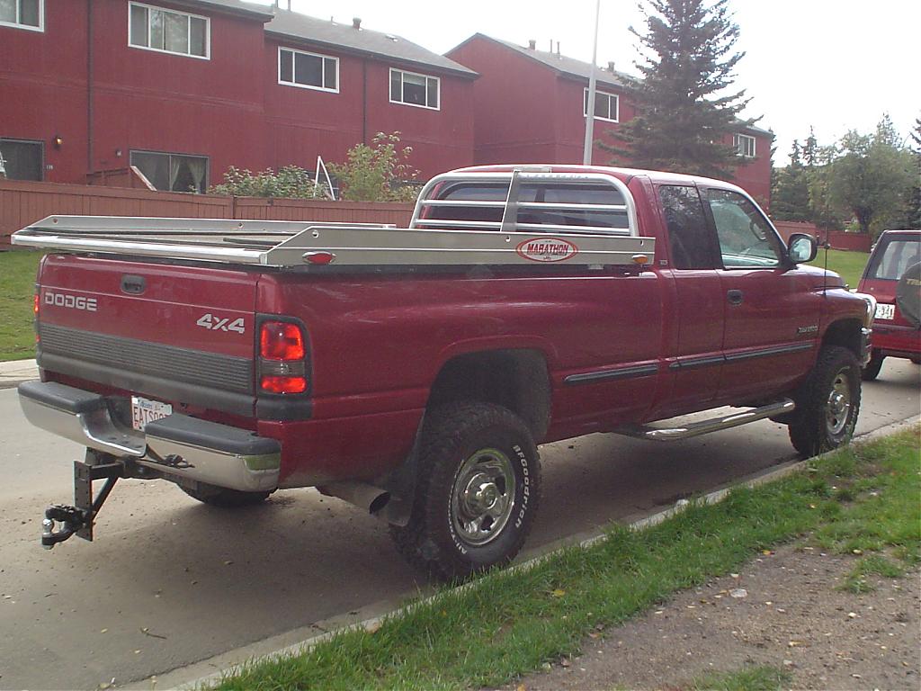

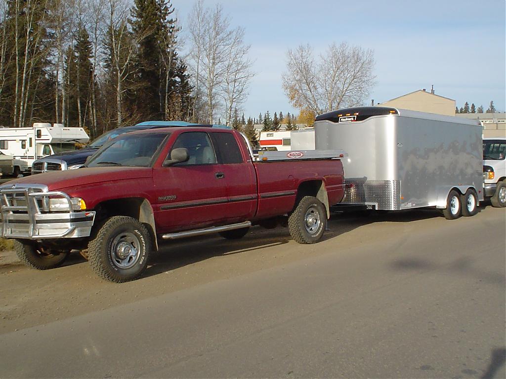

OK guys about to go on 3000 mile journey and I have 1500-1600 in the bed and towing 6000 lbs , Just put on a putnam V but I am worried about the tires they are BFG at D's that are good for 3300 @ 50 PSI , but the factory rims are the old steel narrow ones and the tires wear in the middle @ 50 psi , just worried about not all of the tire hitting the pavement and causeing extra stress ????? I don't know my tongue weight yet ( still some things to go in trailer) but I will try to keep it at 600 lbs , so that will be aprox 2200 lbs on the rear of the truck. Am I good to go.????

Thats what I,m worried about , the alum rims are wider , I have them on my 02 and the 285s on them sit flat at max psi. The older steel ones are narrower maybe 7 inch wide ???? and the tires don't make full contact with the road.Worried about sidewall stress with 2300 lbs on the bed.
