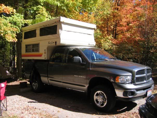

I carry an old Sunlite that originally fit my Dodge Dakota. I modded it to fit my 2500 and it weighs about 1600 fully loaded. I can't even tell it is on most of the time unless I get a good crosswind. I bought it CHEAP about a year ago off dealer listing on RVtraderOnline.

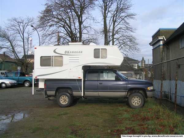

My camper in 1641#'s posted dry weight. Add water, food and equipement for an extra 600-800 #'s and I can hardly feel it back there with all stock suspension, the truck sits level.
[IMG][/IMG]

That sits great! (The 2'nd gens had the overload springs on the 3/4 Ton, like the single axle 1 tons have now.)
