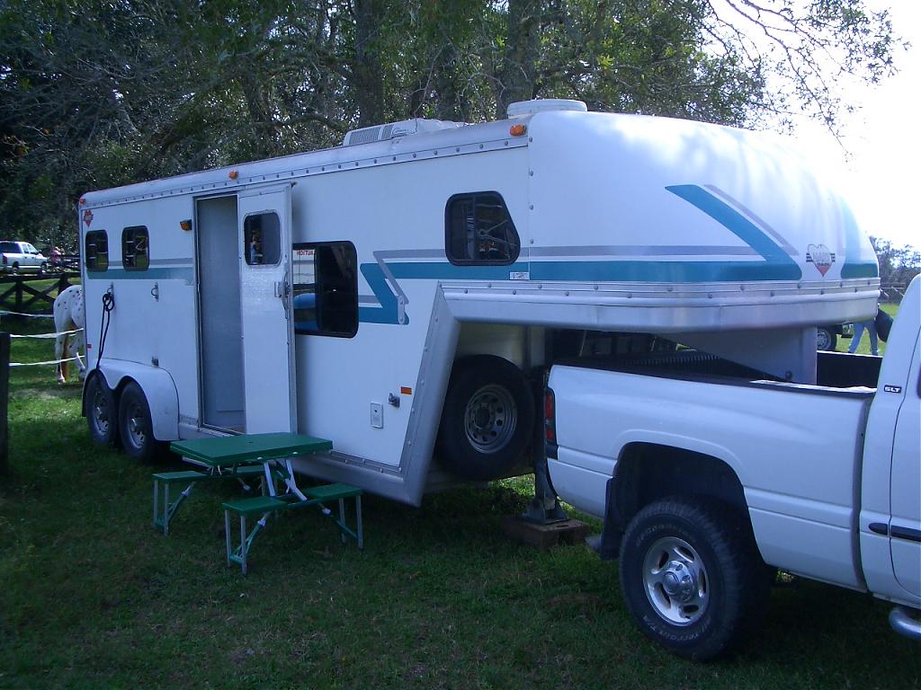

I have a 2001 Dodge 4x4 diesel. I recently bought a heavier horse trailer with living quarters. I have not taken it to weigh it, but the paper work says that it weighed 5,000 lbs before the living quarters was installed. When I tow it, the nose of my truck is up. Also, when I go over a bump it sounds like I am bottoming out. I took it to the truck/RV dealer near me and he said that I should replace my leaf springs before I try installing air bags (Ride Rites). He said that I have standard leaf springs with an overload (which looks like two more leaf springs to me). He said that because the existing leaf springs are not in a smile and are almost in a frown position that he suspects they are wearing out.
He called me back later to say that Dodge says that factory leaf springs are rated for 1700 lbs per side and that he had a price of ~$400 per side for new ones that were rated for 2850 lbs per side.
He suggested replacing the leaf springs first, then if it isn't enough he says he can remove the overload springs and install the ride rites. When it is all said and done I will have spent almost $2,000.
You probably have guessed that I am not planning on doing any work myself; however, I am trying to make an informed decision. I have a couple friends who installed the air bags and are very happy - so I was confused when the shop started talking about my leaf springs. I know that you have all warned about the really stiff ride you will get all the time with a heaftier leaf spring instead of the air bag option.
Perhaps I should just tell them to forget the upgrade to the leaf springs and just remove the overload spring and install the air bags...
I attached a picture of the trailer.
Any advice would be appreciated.
Attached Thumbnails Help for towing horse trailer w/ LQ-cimg2056.jpg

I don't know where my reply went, but I don't see it. I didn't see the thumbnail at first and suggested a wdh.
I see now it's GN. Does your truck have the extra leaf springs? Not all 2500's got them.
The tires look awful close to the tail. I'd bet you do really have a very high % of overall weight on the hitch. Any possibility of moving the ball forward an inch or two? You need some weight transfer.
You really need to get it weighed too. Overall weight and pin weight. How fancy was the inside built? Heavy cabinets? Ice Maker? All that add up real fast. Do you tow with full water tanks? Water add a ton of weight.

Did you ask for those axles to be placed that far back?
Old Jan 14, 2008 | 11:40 AM
appaloosa's Avatar
Joined: May 2003
Posts: 19
From: Florida
Unfortunately, this is a 1996 and I just bought it last year. So this is the design that Hart uses.
