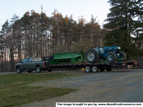

This load was somewhere between 15,000 and 18,000. I knew it was back there powerwise, but it rode perfectly. I wouldn't want to tow the same load on a bumper pull though.

ptm600: What axles are they, 7k's??
