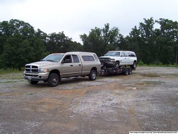

I tow between 8k and 10k all the time with no problem so it works for me.
This was the last 10k tow 5 + hrs
