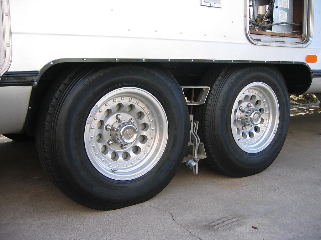

I went from ST tires that I did not like to an LT tire (with a narrow tread) that DISCOUNT TIRE did not want to mount for me, as:
- they were not ST
- I was also installing Centramatic balancers
D-T did the mount of the tire to wheel, and the balance on a Hunter-GSP-9700; I then mounted the balancers and wheel/tires in the parking lot (using their jacks).
Comparing the tires I bought to the GYM's most would recommend noted this: The Marathons (an ST tire in 225/75-15; LR-C; 2,600-lbs) had a lot more bulge and sidewall scrub on tight turns on a tandem axle trailer. The YOKOHAMA RY-215 LT tires (LR-D; 2,040-lbs) were of heavier construction. On a lock-to-lock u-turn on a fairly fresh asphalt parking lot the Yoko's exhibited next to no "flex" and simply pivoted on the tread.
I tried the same on a warehouse district concrete road and found things to be the same.
The load rating was the same for both, roughly, and the GYM's were rated for higher weight. But, on this travel trailer, either tire met trailer manufacturer recommendations.
Tire temps never exceeded 125F even on a hot, stop & go 105F Texas day on the highway in late August.
