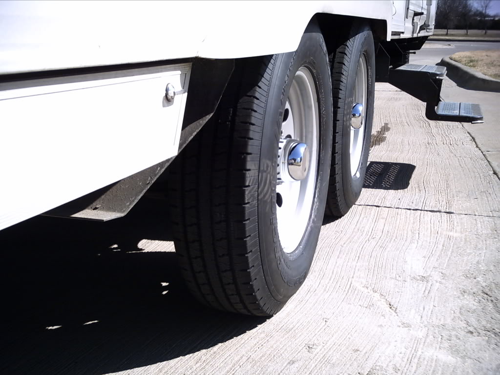

Are you sure it will cost you $3 grand to go to 16'' LTs? I bought 5 rims and tires (including a brand new spare) for my toyhauler it was well under $1000 at Discount Tire. I guess if it is a chrome aftermarket rim they would be more.
These are plain, relatively inexpensive 16'' rims and BF Goodrich Commercial LT truck tires on my toyhauler that replaced the stock 15'' ST tires. When they need to be replaced I will be going back with the same. If I eventually get another RV trailer, I will be switching them out. No more ST tires for me. Good luck with your purchase.
