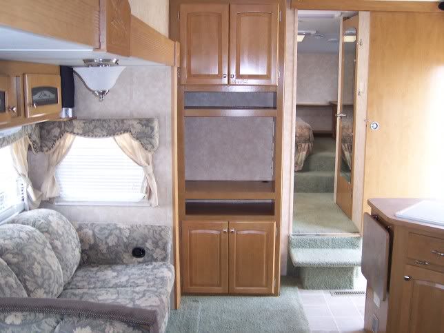

I have a eager wife and 11 yr.old pestering me daily, I have BEEN back in the market since last Saturday.
I bought another one yesterday. It's a mid-profile, much higher in the front, and newer of course. I have the install kit for my hitch, the hitch itself comes in Monday.
The one I am getting now is night and day compared to the older Dutchmen I was looking at, totally different trailer (with a totally different price)
It's very nice, another Bunk House, this time with a bedroom slide, much nice shower and a totally enclosed underbelly. Only thing I dislike about it is the rims/tires. I am going to try to find a decent set of Aluminium 16's for it.

PJ, THat's a nice looking trailer. Layout looks alot like our jazz other than I don't have the bed slide. My trailer came 15" rims a year ago when I bought but now come with 16" rims, frustrating but I'll just have upgrade when I need tires. Gald you got somethnig that will work for ya.

Thanks. Funny, I looked very seriously as a 2003 Jazz. It actually has a bunk design I prefer (extra back door). Other than that and the bedroom slide they are very silmiar units.
